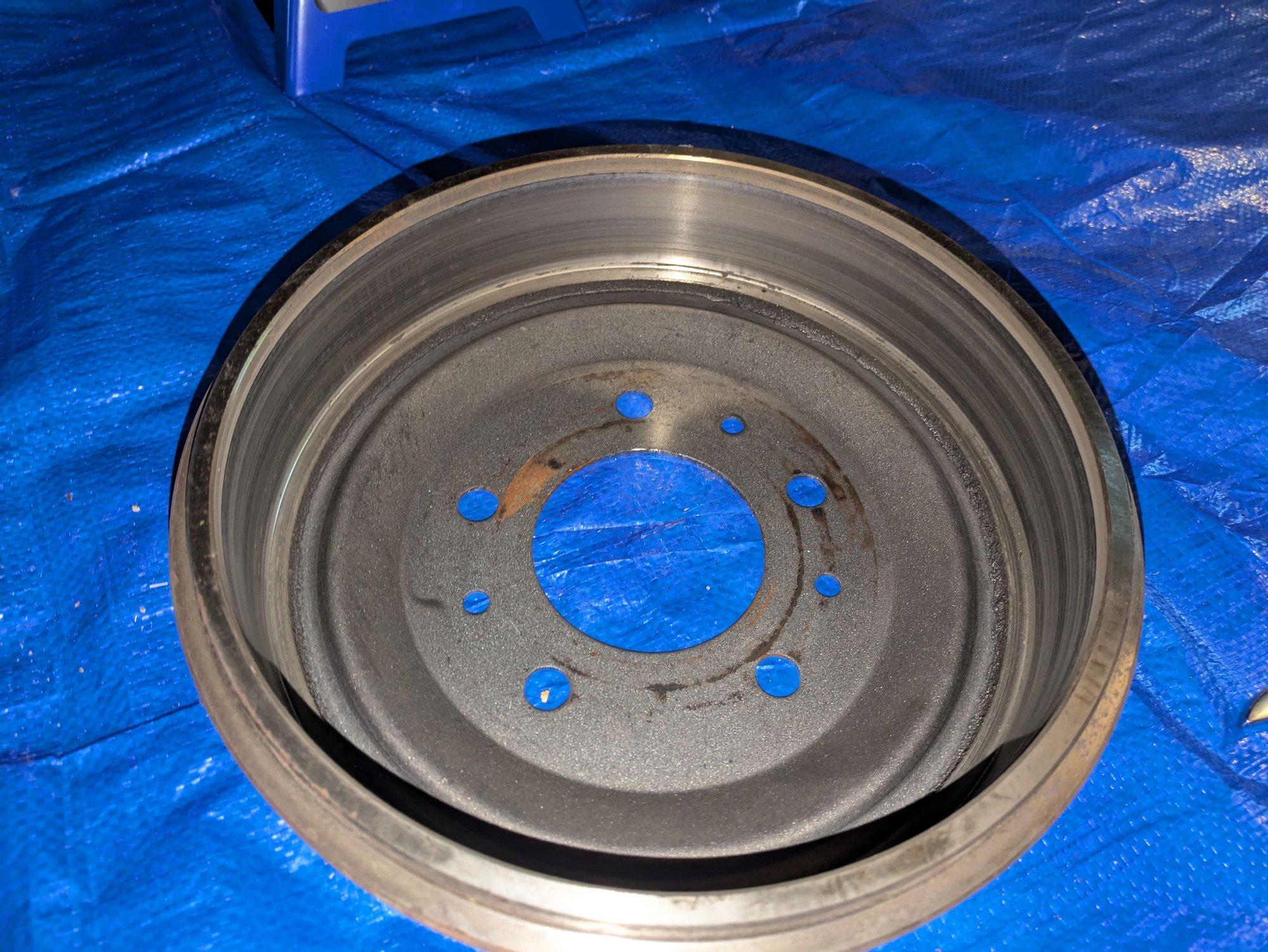

Can you elaborate? I am taking apart my front drums now, also '67 (2wd). Oddly I have two different drums, passenger side came off no issues but hub/studs is not part of the drum. Driver's side appears stuck on (freely rotates from the pads) but doesn't have the same bolt pattern. I was assuming the drum comes off the hub similarly to the passenger side.
Passenger side - Came off without the hub, note three holes in-between 5x5. 5 stud holes
Driver's side, current frozen - Doesn't have the other hole pattern
