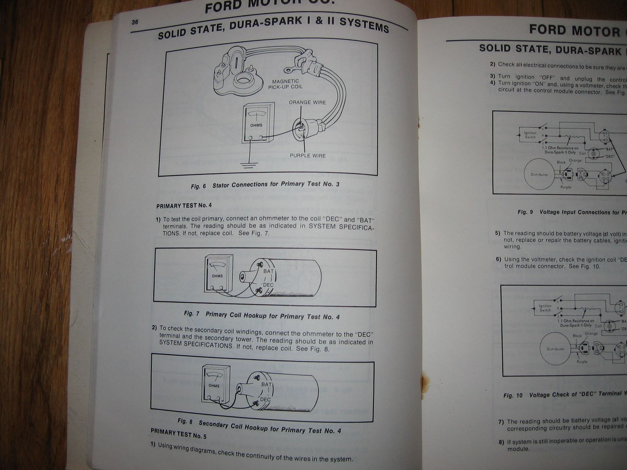

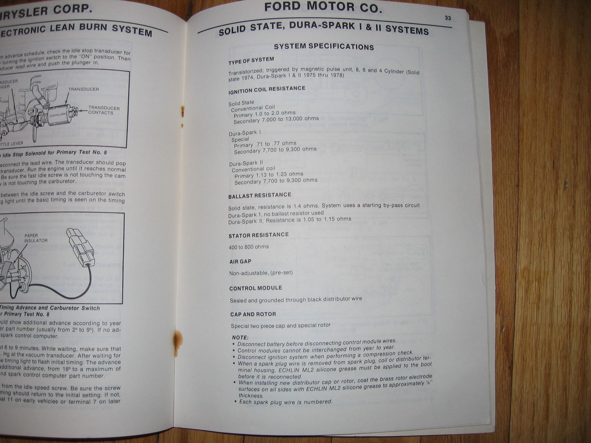

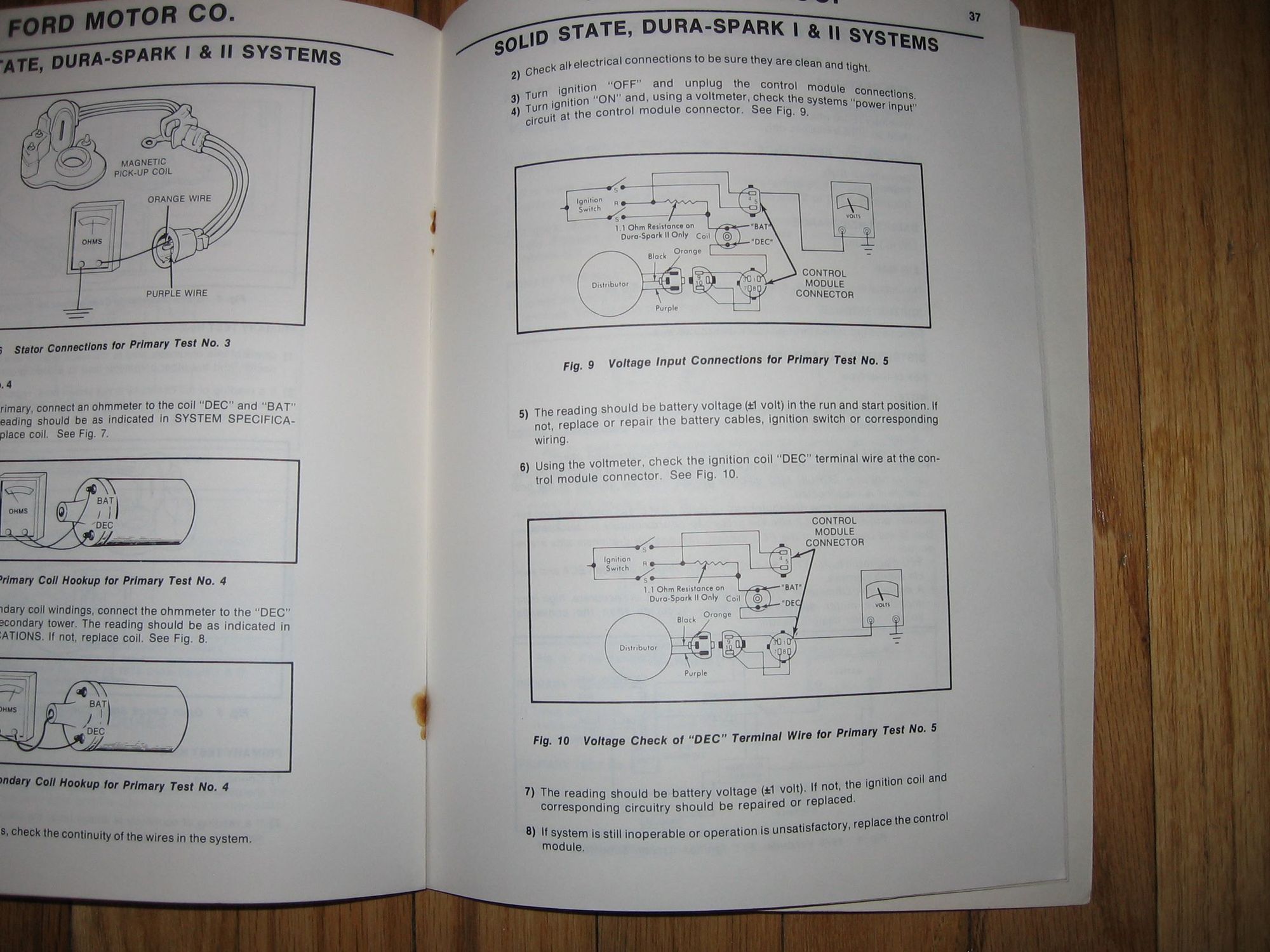

If it just shut off like someone turned the key off and being a 79 model year I would say the ICM, the box on the inner fender with 2 plugs, stopped working.
When you get a new one from the parts store do not go for the cheap ones, spend a little coin for the better ones as they will last longer.
If you replace it and still dose not have spark keep a box in the truck for when it will go bad.
You dont even need to bolt it down just unplug and plug the other box in.
