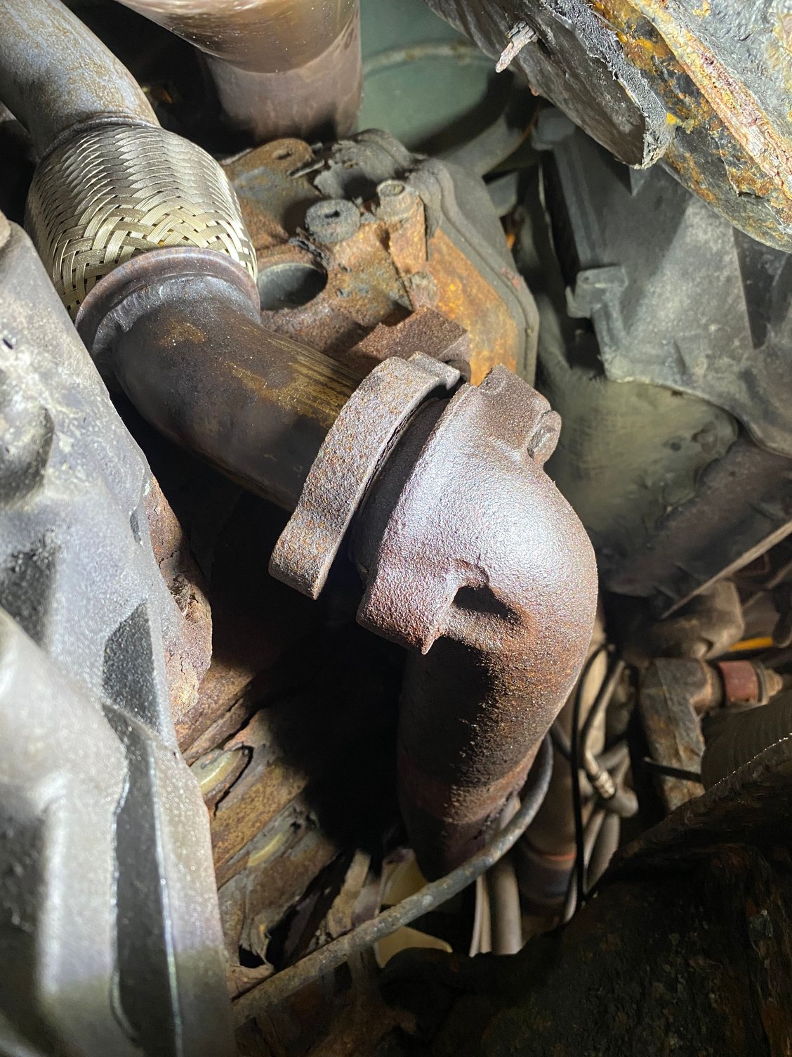

Hello everyone. A number of years ago I had replaced a cracked passenger side manifold with a Napa manifold. Since it came with a gasket naturally I installed the gasket. Fast forward to today the gasket has blown out so I opted to install a ford manifold from Riff Raff diesel, which out of memory does not use a gasket. So far I have obviously identified where the gasket blew out, removed the passenger wheel as well as the inner fender to gain access. Let the fun begin.

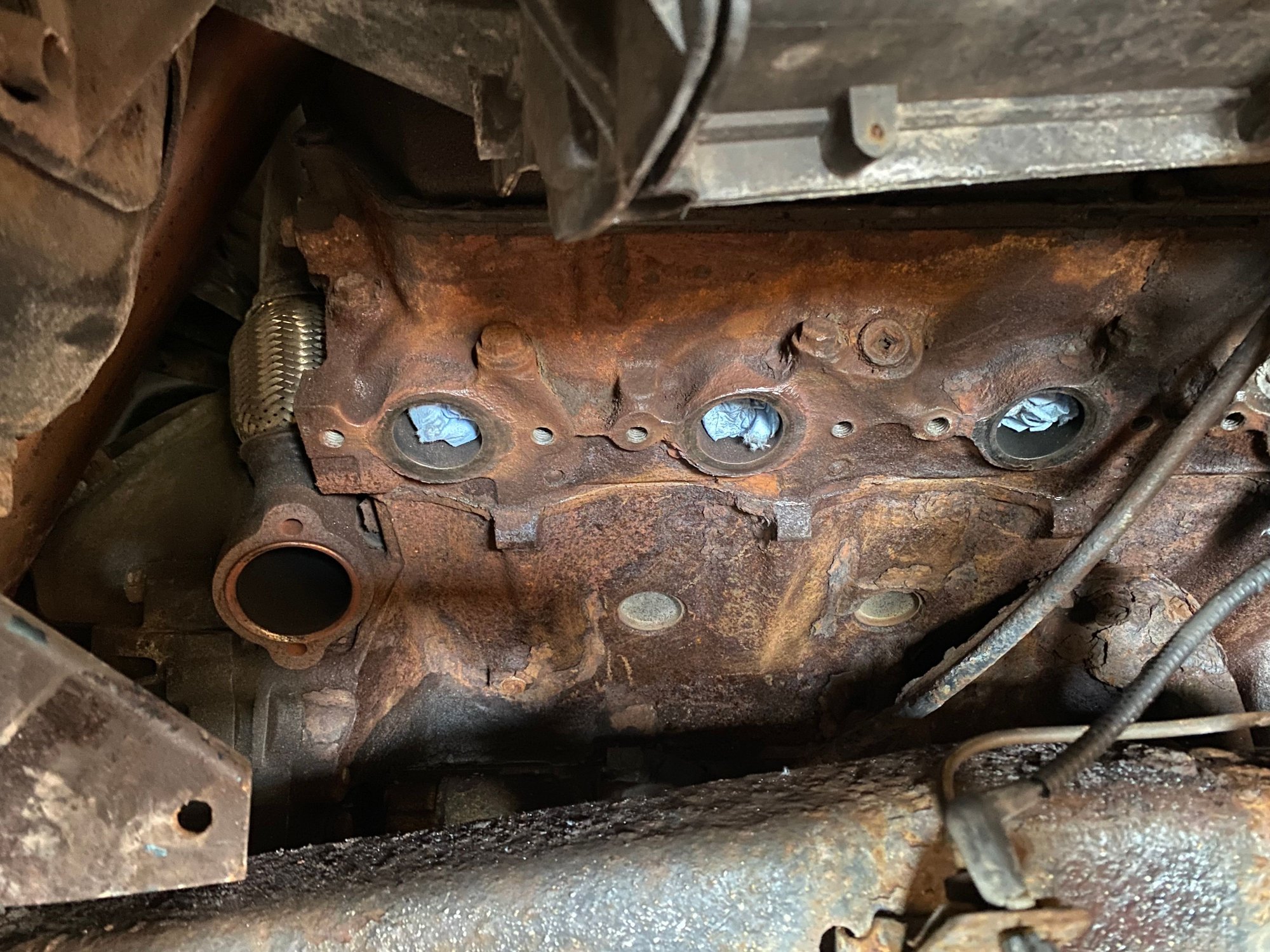

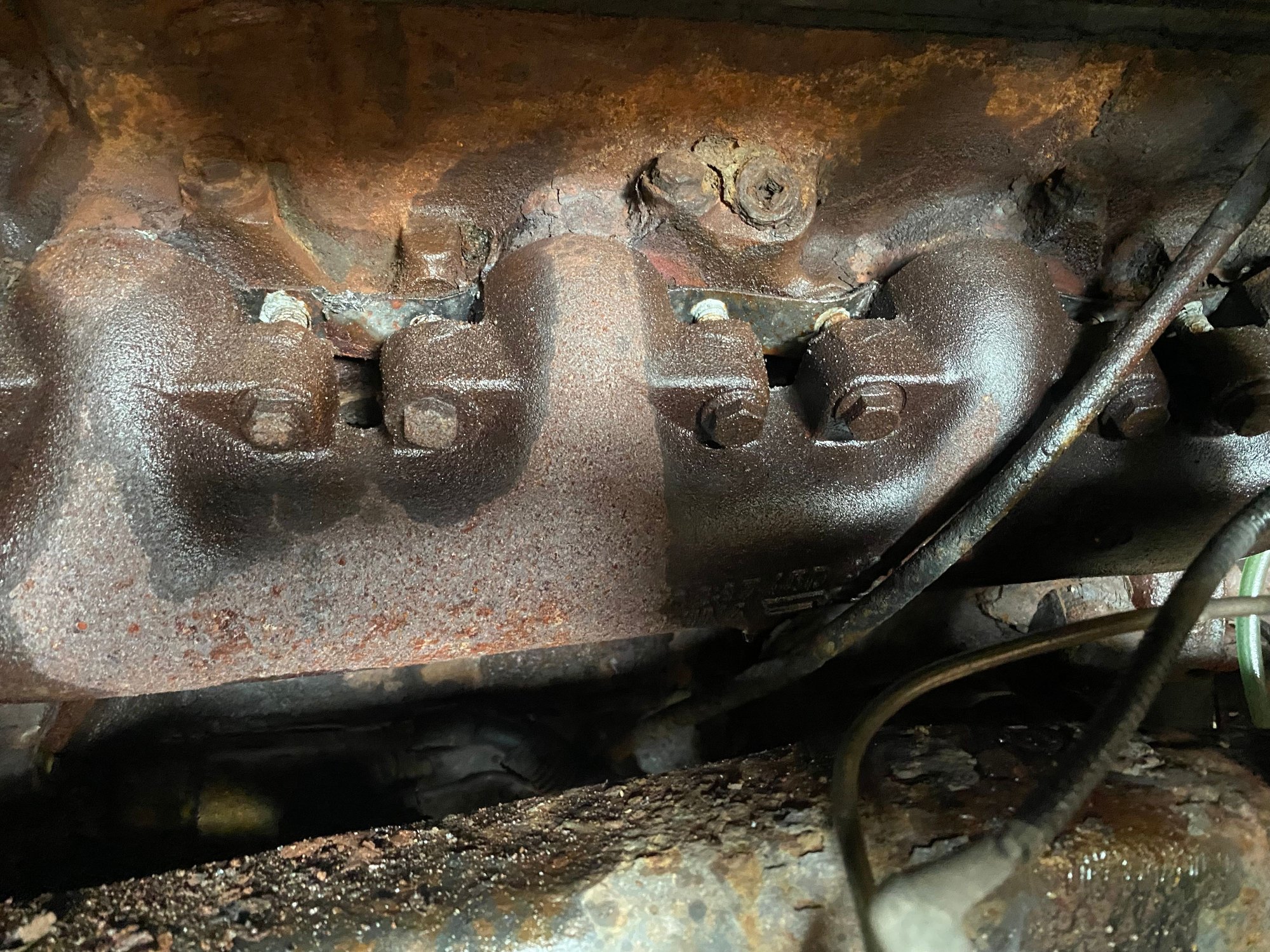

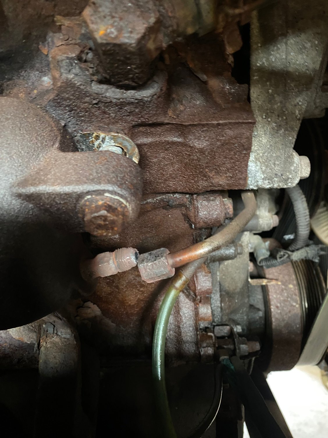

The first bolt broke, which made it easy to get out from where the manifold connects to the up pipe. The second was hardly more then finger tight.
Maybe 2 hours to get this far. All done for today.
Had to heat the nut on the pipe Cherry red to get to off.

I just did this last week, ended up going with a new oem manifold. Had to helicoil the very front drive side bolt hole, threads came out with the bolt(bolts had been replaced by po and obviously run into dirty holes with impact...)

Yes in New York. Glad you got yours done, although the helicoil was likely unexpected extra step. I was expecting the bolts to be seized by rust in the manifold but to my surprise they came right out.
