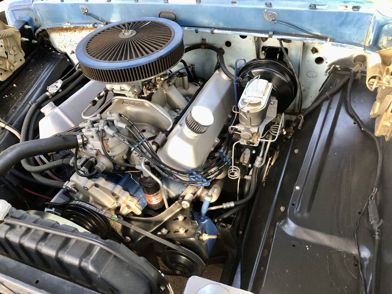

Engine bay is identical on a 72 with 73-79 factory perches and mounts.
My 72 has a 385 series engine with headers that bolt in without steering box clearance issues. I can take some pics tomorrow. Pretty sure they’re Hooker headers.

I have the Hooker Super Comp headers. I had to notch the intermediate crossmember, just a bit, on the left side. The Super Comps hang low but I wanted them because they have larger diameter tubes than the standard Hooker headers. The standard headers do not hang low.

Doesn’t look like it but there’s at least 1/2”-3/4” clearance on the steering box.
This is great!
I can tell by the exhaust ports that when I install the 429 engine mounts the header will be a touch higher than where it is currently. which I'm happy about. at least it looks that way.
much appreciated.
