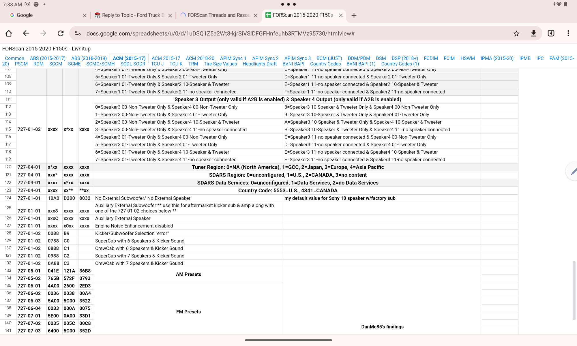

You can change the tuner region in Forscan from North America, Europe, Japan, Asia Pacific. Is Australia the same as any of these? But I don't know if you need different hardware. I'm sure DAB radio in Europe requires different hardware. The attached screenshot is for 2015-2020 Fords. You need to check the F150 spreadsheet, look at ACM, for your model year.
