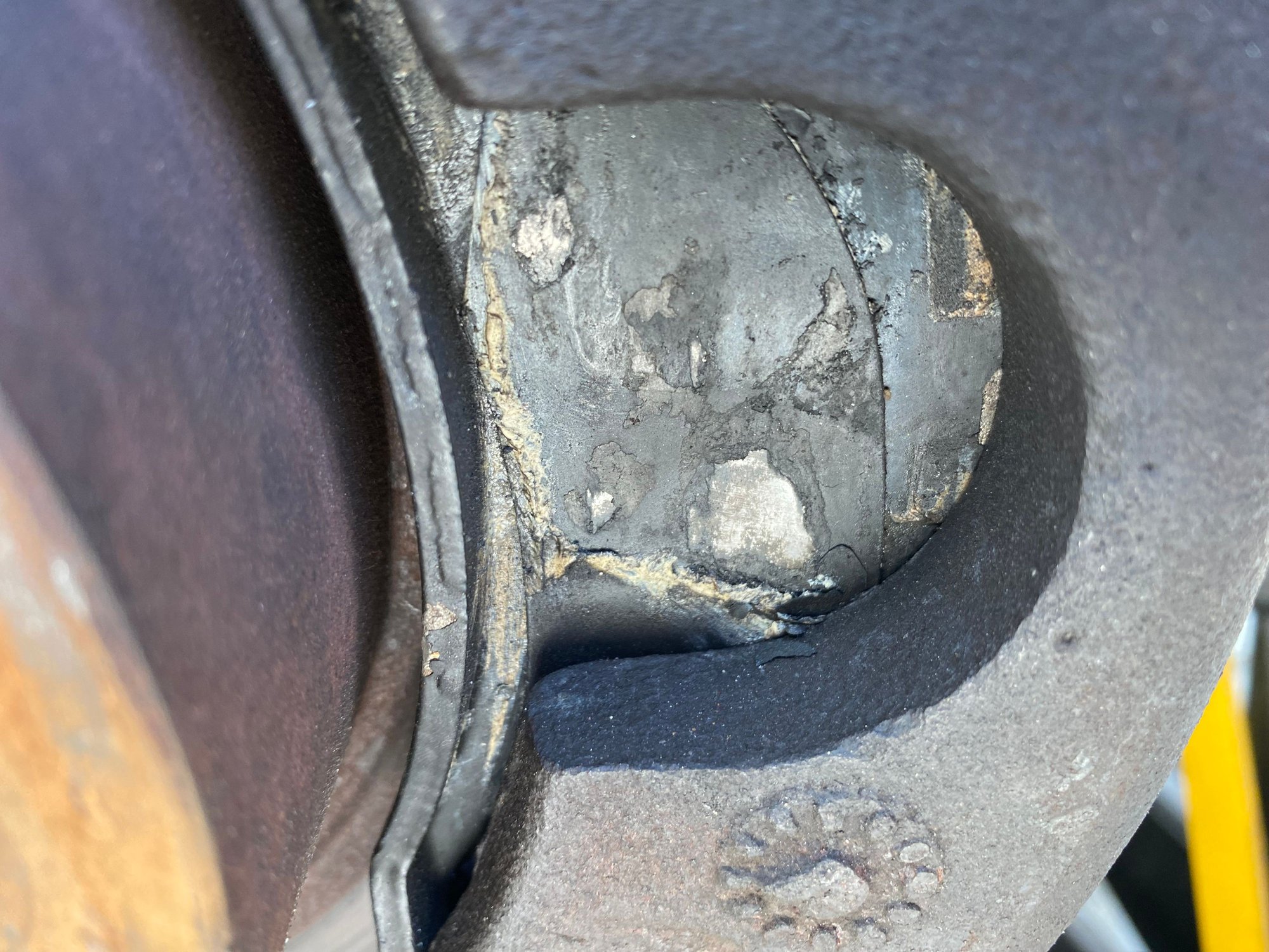

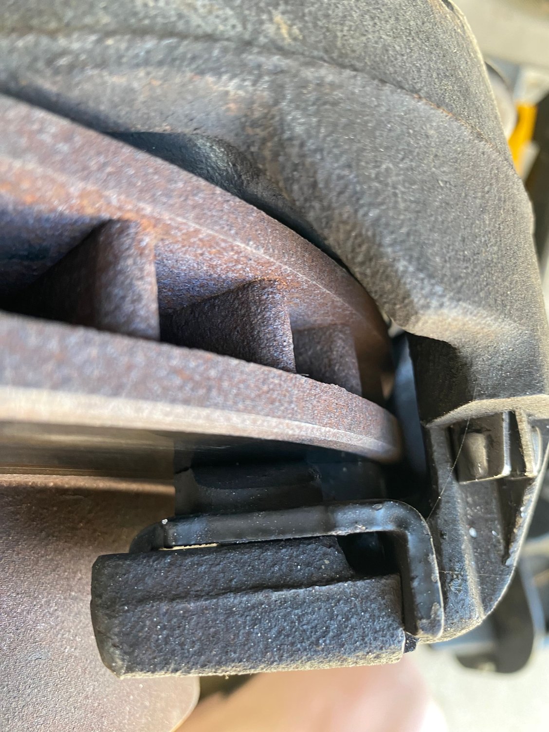

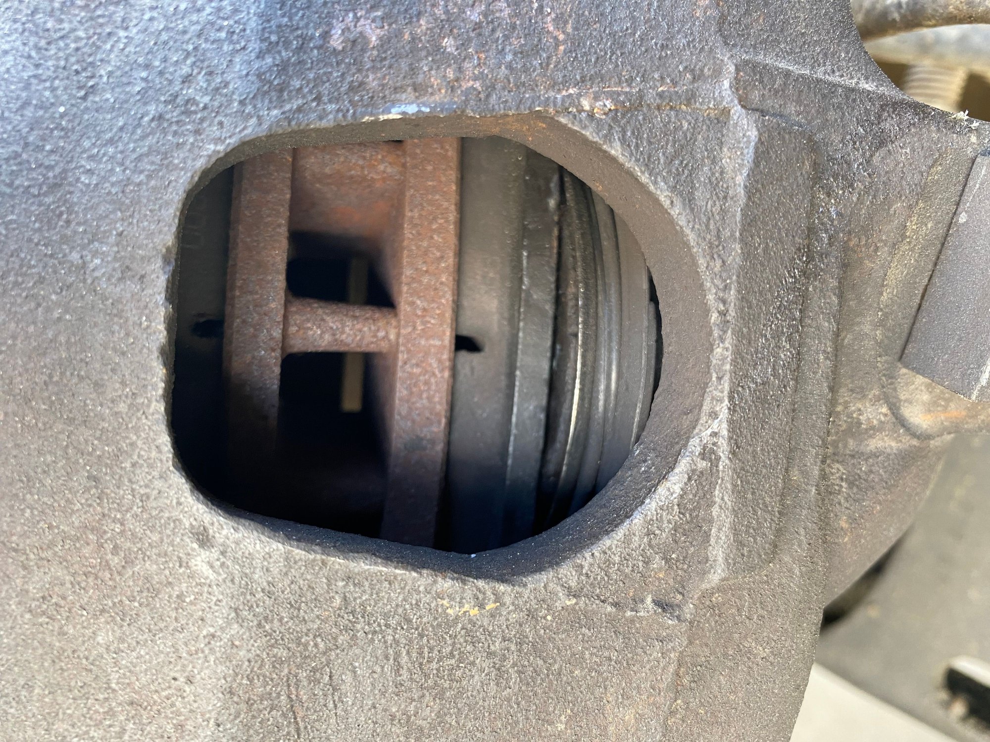

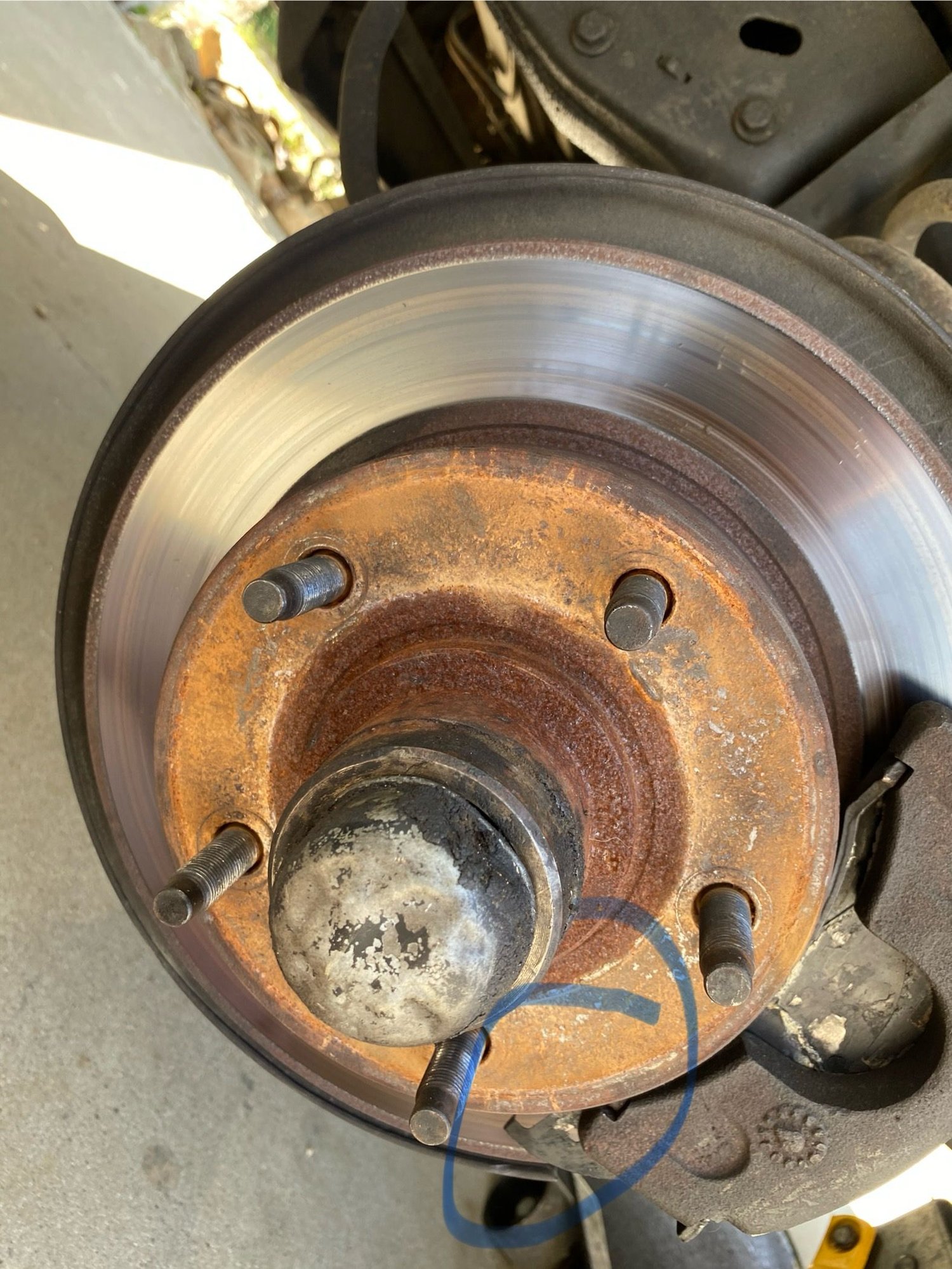

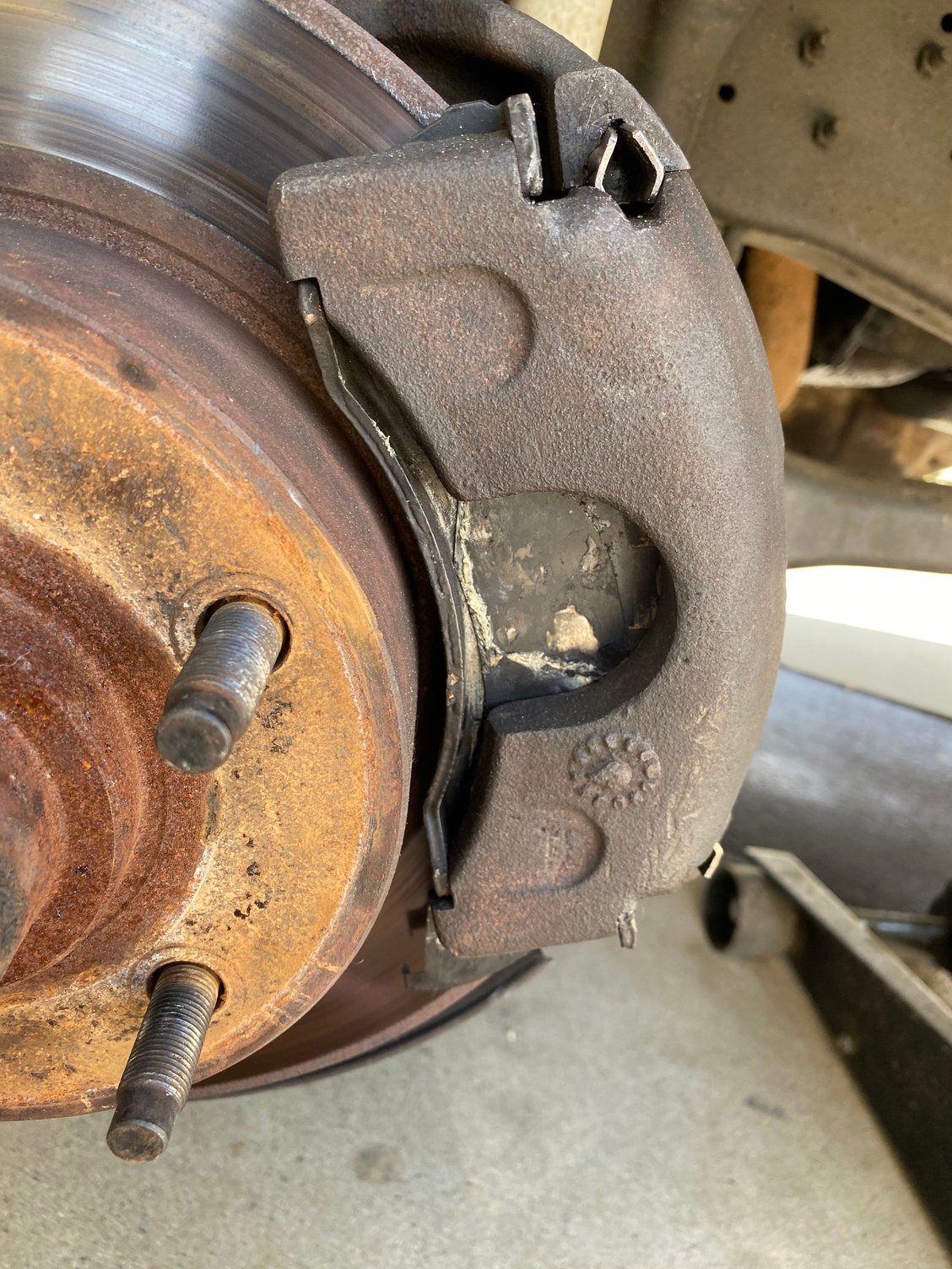

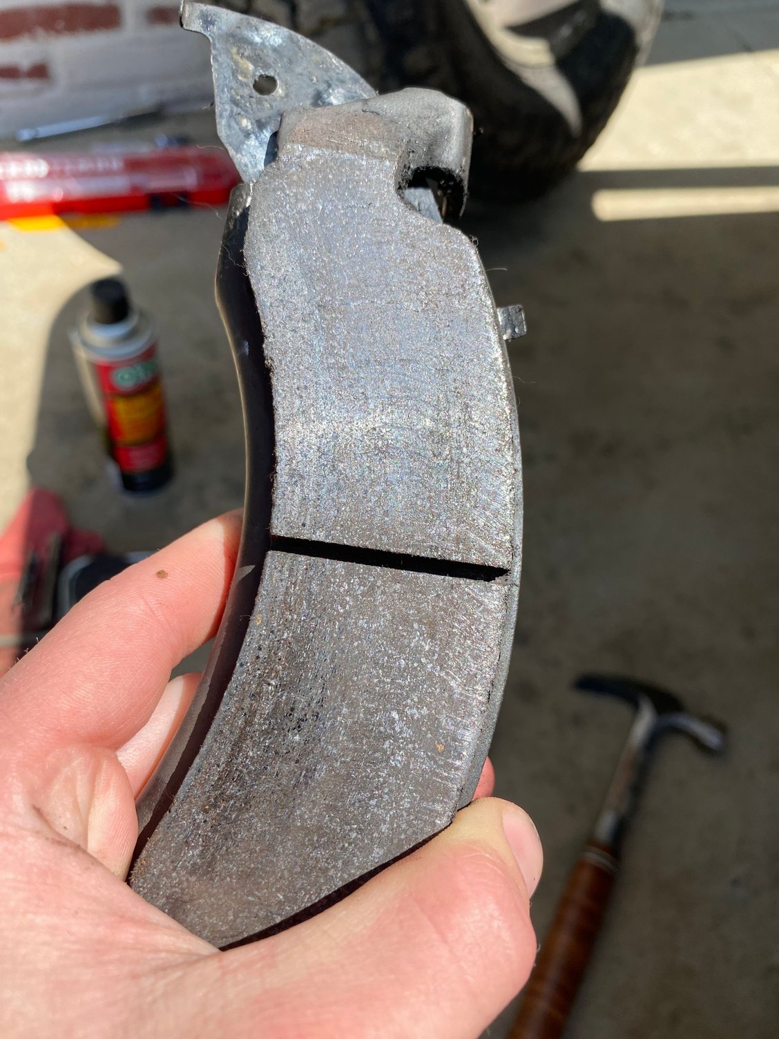

Do these look glazed? Also the pad backing plate had slipped out before i compressed the pads that’s fixed
The squeaking also only happens in drive. Not in reverse
