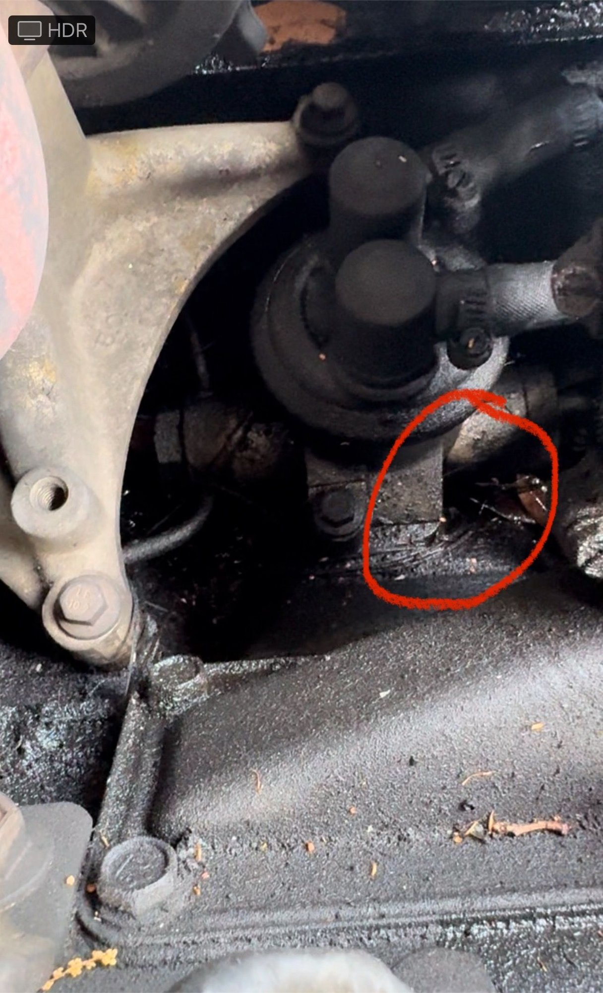

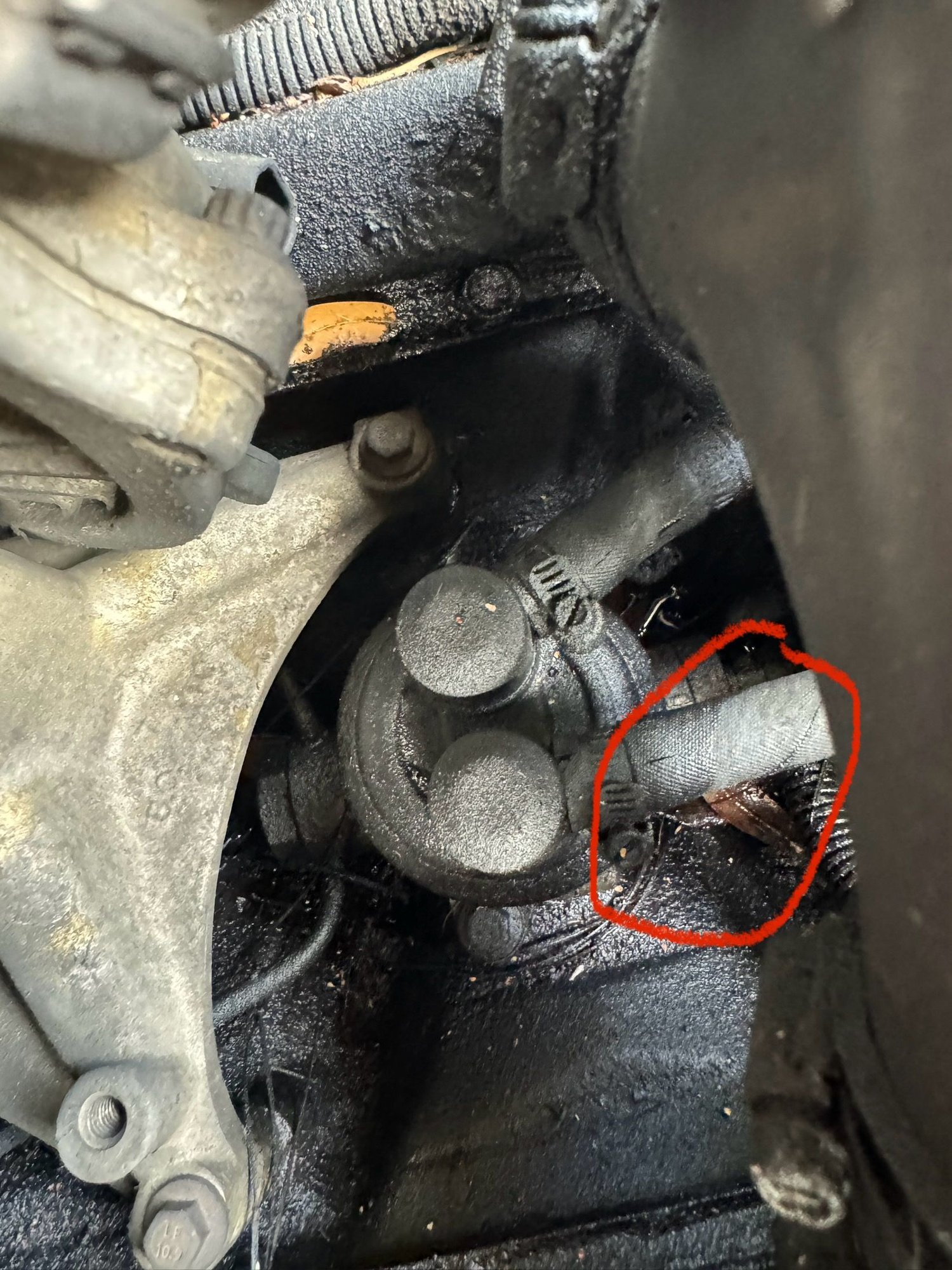

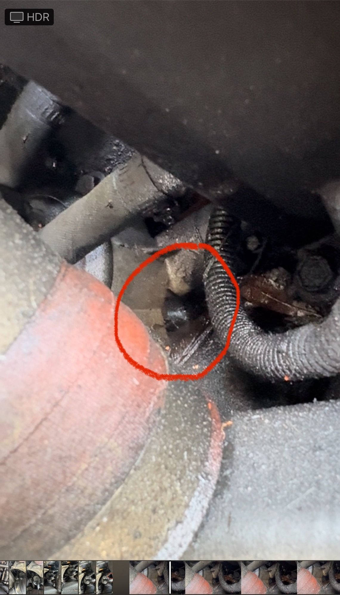

I’ve got a 1997 7.3 and it’s leaking fuel pretty steady. I’m not able to attach my video, but I took pics from the vid to show where the leak is coming from. Would this be a bad lift pump? Thanks.

pump and or fuel hoses
I did mine years ago and did the bowl rebuild too.
make sure you do this prior
https://www.ford-trucks.com/forums/1...-to-clean.html
hoses
https://www.riffraffdiesel.com/fuel-pump-hoses/
pump
https://www.riffraffdiesel.com/mecha...uel-lift-pump/
bowl kit
https://www.riffraffdiesel.com/compl...-drain-orings/
