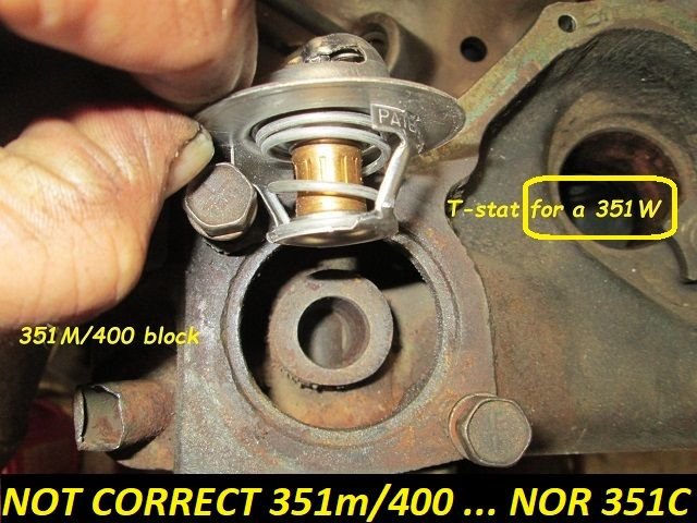

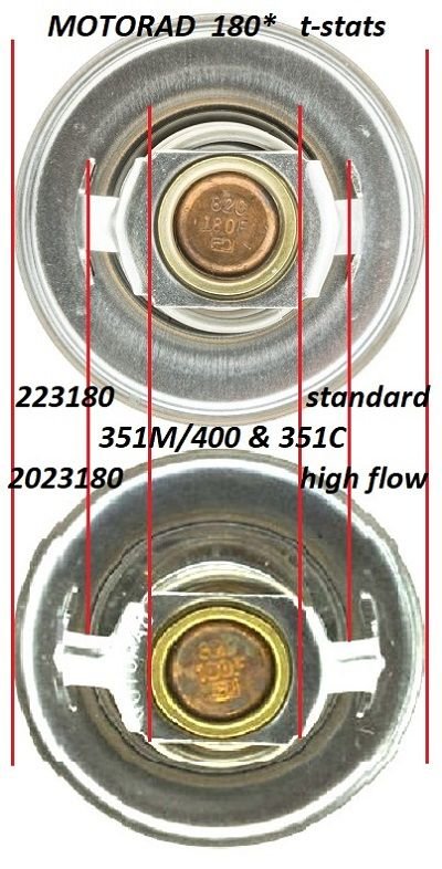

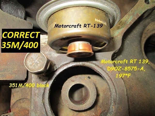

Exactly who's thermostats have you used, what part numbers? 351Ms, 351Cs, and 400s all use a thermostat many are unfamiliar with.
  • When the engine is running and is cold or cool, the water pump is pumping, and as the thermostat is shut, a bypass is open allowing coolant to bypass the radiator ... to keep coolant moving and prevent cavitation in the water pump.
  • When the engine reaches hot, the thermostat opens, and as it opens it has a feature to severely reduce flow through the bypass. Coolant keeps moving, but as long as the thermostat is open, the coolant is force through the radiator.
  • The correct thermostats have a "hat like" featur that has a raised brim on the small end of the thermostat, it inserts into a hole in the block on the 351M and 400, or into a brass restrictor in the 351C block. It is smaller than the hole, but not a lot smaller, it restricts that path.
  • If a thermostat is used without this feature, hot coolant from the heads will just go into the water pump through the wide open bypass just to get recycled back through the block, never having seen the radiator. The engine will just keep getting hotter and hotter.
The correct thermostats have the hat and incorrect thermostats do not have the hat.
Note that they all have "the hat" on the bottom. These above are 180* ... but Motorad also has the 223192 standard flow and the 2023192 high flow versions for 192*. Currently I'm using the 2023180 in mine, and while temps can drop to 180 on long cool down hills, typically I see 190-195 on level or up grades. No doubt, most all thermostats start to open at the designated temperature, but only reach full openness when maybe 10-15 degrees hotter.
