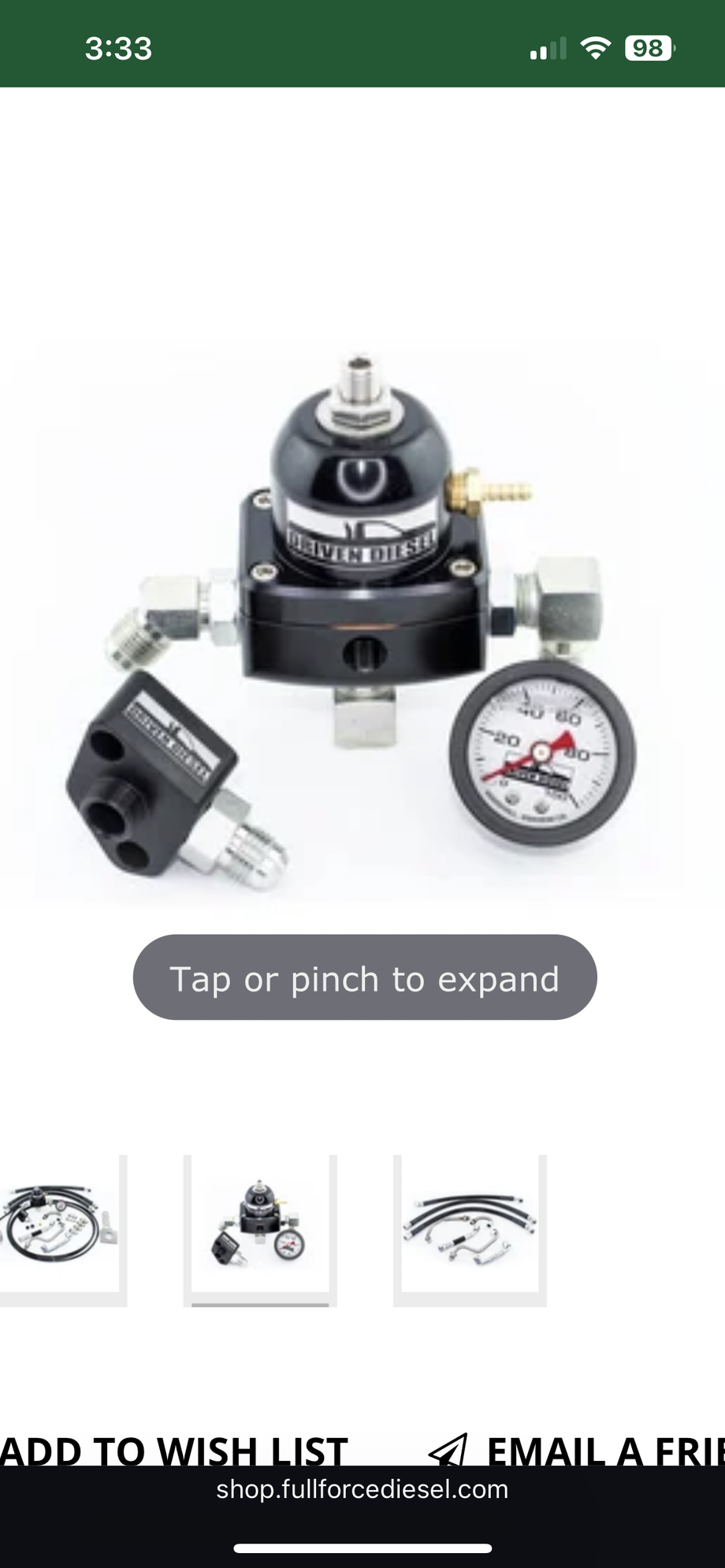

You see something like this in place of bowl?
