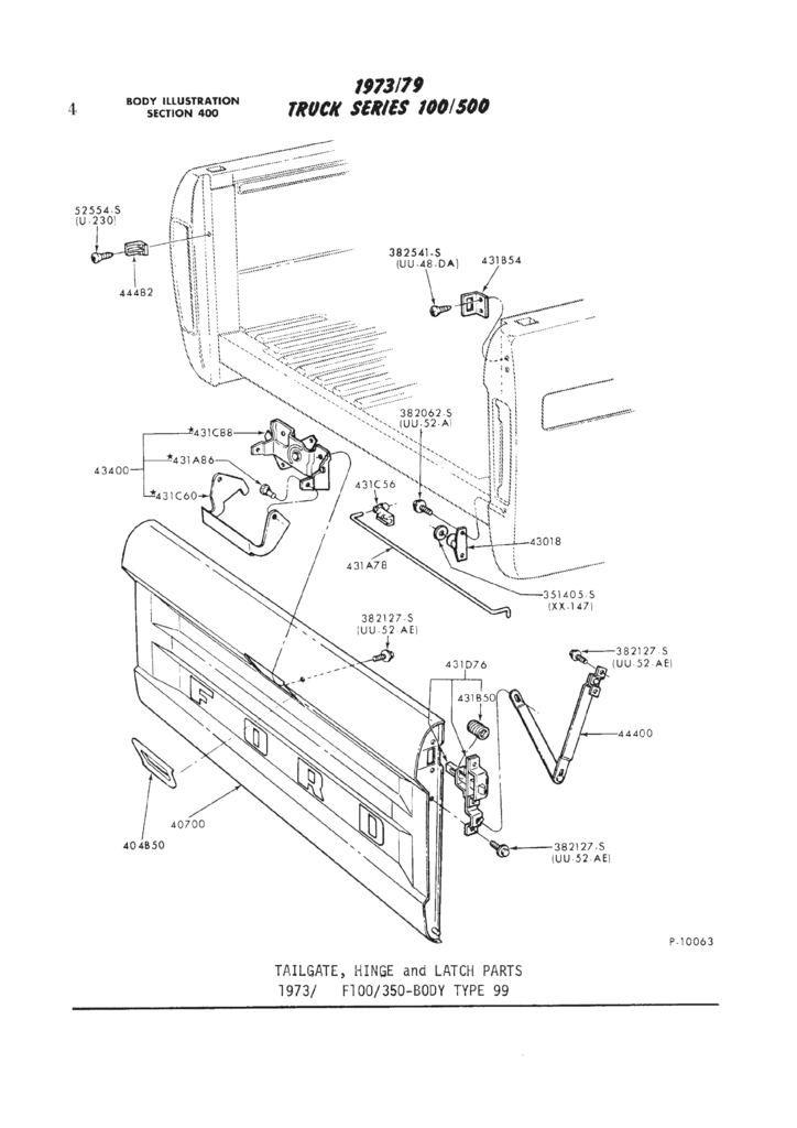

I'm looking for these little rod clips for my tailgate handle. 5/32" is the size I'm finding online for Ford vehicles. Can anyone confirm the size?

Nice project, X2 get it to start, stop and steer reliably before you do ANY thing else. I bet that tailgate rod clip is the same as a interior door handle rod clip. #431C56 for the TG. HELP dept at most auto parts stores.
