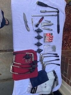

Replaced plugs, wires, and coils this past weekend at 93k miles
I bought the plugs from ebay CYFS-12Y-T6P for $74.99 (12 of them and I don't know why). The plug wires and coils came as a set from Levittown Ford Parts as a kit for $293.61 (part # M-12029-SD73). There were several email exchanges with the guys there to check on the latest replacement plug wires (since I followed several sites discussing the differences). They did send the LC3Z-12286-D plug wires. The original price quote had the "-A" plug wires. Replaced 5-8 initially and torqued to 133 in lbs. The coil clips did not come off easily. After pushing the retainer up and out of the way, I needed to gently pry the sides of the clip up with the edge of a wide screwdriver. Plugs were a bit difficult to remove and looked like some rust had formed on the threads so I put a small amount of anti-seize on the new plugs. I got the first 2 plugs on the passenger side easy enough by pulling the 2 hoses out of the way and tying them off. I had to remove completely the wheel well liner to get to 3 and 4, reaching them with a foot long extension. Putting that back on was the hardest part getting the holes lined up. I'm no mechanic, so 4 hours, but I took my time and did everything right. Price was right for my 2020 F250 7.3L gas engine.
Levittown Ford coils and plug wires kit.
