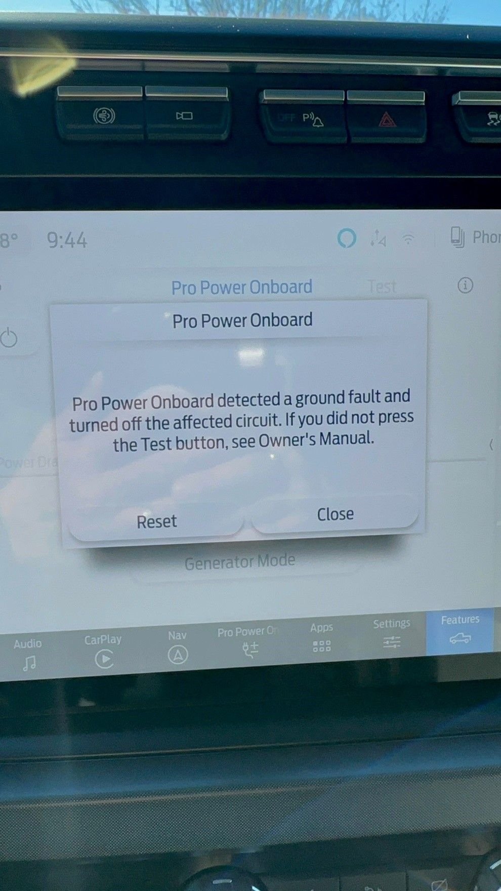

Flyct is new to the Super Duty but had our Airstream for 5 years now. I was hopeful that I could charge my batteries or even run the smaller AC unit(13.5) from the Pro Power. My Honda 2200 can run that AC., so I was hoping the Pro Power would run it, too. When we have a stop in hot weather, it is easy to leave the truck running and start the AC in the trailer. Or top up the battery bank if need arraises. I plug it in and just recieve a ground fault. I ran the Pro Power test, and I received the same error message.
I think something else is going on. If I unplug everything, turn on the inverter and run the test, I receive the same error message.

I took my '24 F350 KR to the dealer yesterday because I've been getting the ground fault messages. Whenever I drive through puddles or go to a car wash, the generator malfunctions. I've gotten shocked twice while in the bed of the truck. Here's the issue: the Ford dealer told me they can't fix it since the computer isn't showing any error codes. I've reached out to Ford, but everyone I speak with evidently believes this is just normal behavior and that nothing is wrong. This is a safety concern that Ford seems to want to overlook. Sorry, Ford, I just can't let that happen.,
Does anyone else have the same response from their Ford dealer that 'they can't fix it'?

I too have this issue of plugging my trailer into the f250 2k generator. Trips the gfci every time. My manual says the generator is,
"Grounding Type
Neutral Floating
The neutral of the inverter generator is
isolated from system ground.
Note: If additional grounding measures are
required, consult with a qualified electrician."
So, if my trailer used a bonded ground to neutral, it is gonna trip the gfci every time. I tried a ground/neutral bonding plug in one of the trucks outlets and it tripped the gfci also. Did you get any resolve OP?

I tested my truck outlets and found the plug in tester showed neutral and hot reversed. When i pressed the test button it tripped the gfci. I tested the outlet with a good multimeter and it leveled out at 50 v on the hot leg and 77 v on the "neutral". I did not test the resistance between the neutral and the ground as i assume it will be an open. weird test results.
