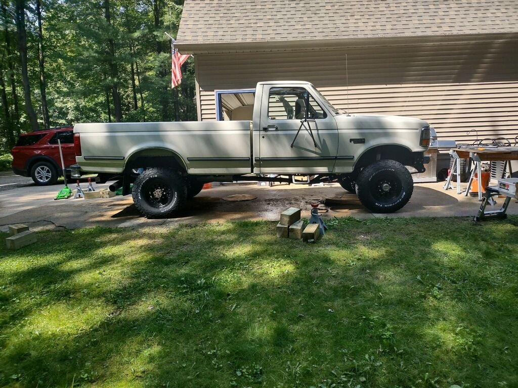

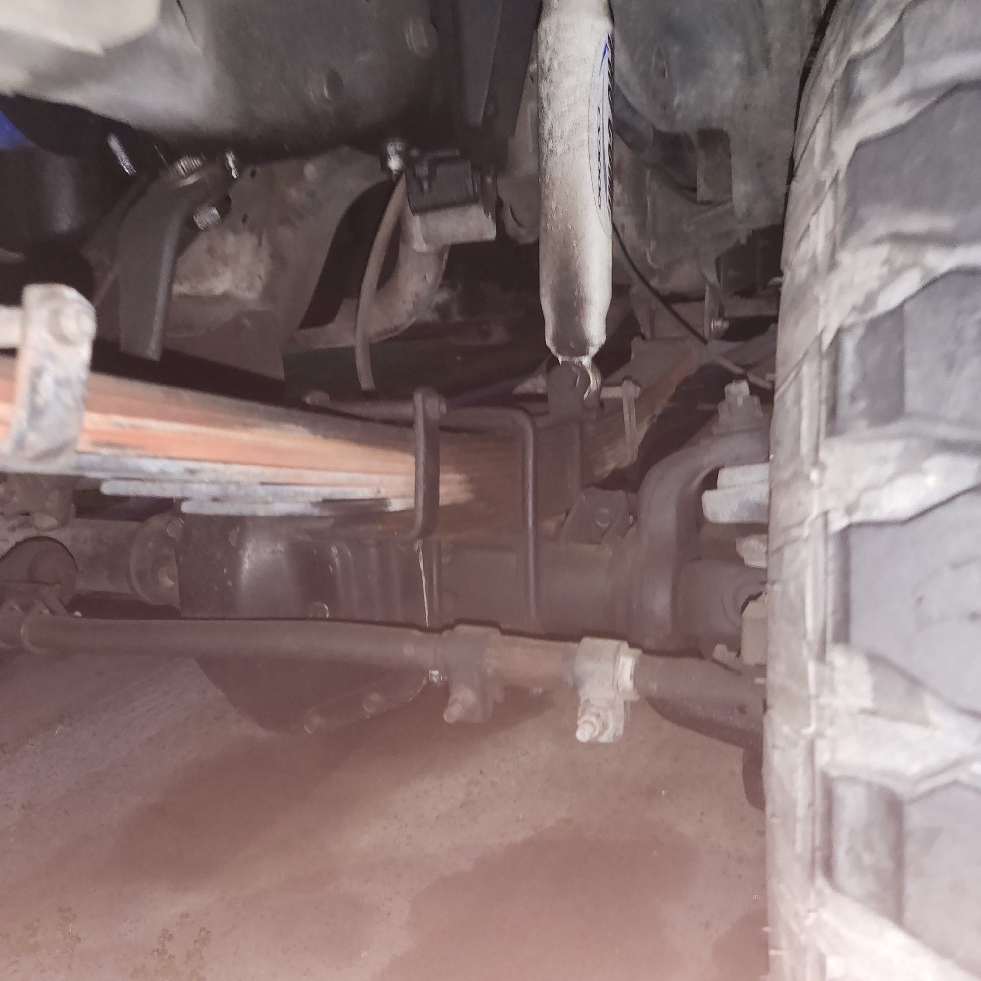

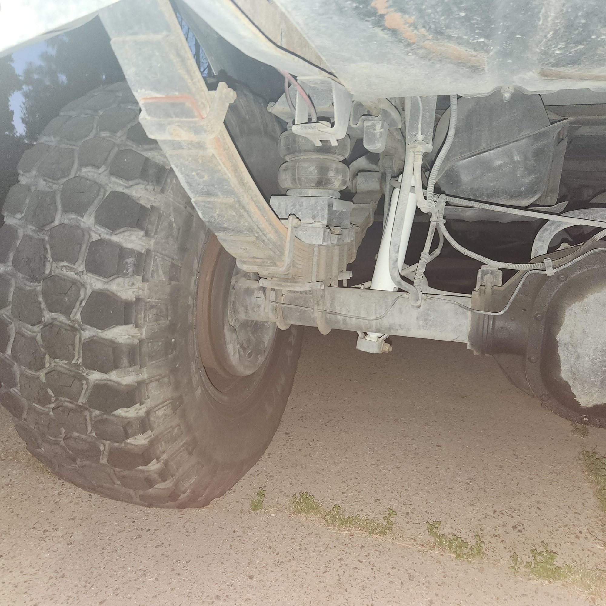

I'm thinking I may not have a lift but just some big tires on my truck. Here are some pictures in case you guys think otherwise. And thanks for the help!

Yeah that has lift springs, the stock front spring packs only have 2 leafs and sit flat or even with a slight negative arch depending what engine they are holding up, there is a factory rear lift block between the springs and axle that your truck is missing and the factory springs don't have that much arch.

factory also does not have air bags in the back
