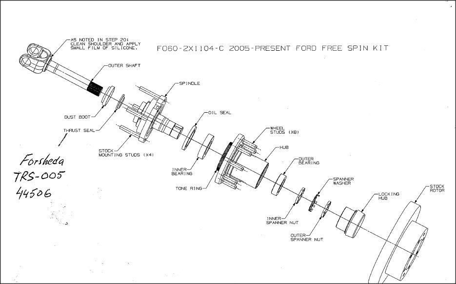

Amazingly, the Moog unit bearings I bought from Autozone have lasted the longest for me so far. I will be considering a free-spin kit the next time they go out.
Nah, for the money they want for those free wheel kits you should just slide a Rockwell under there. Then you can start training your truck to fly.
In my case a conversion kit was best choice for peace of mind, having a dually with hub extensions!
By the way, the factory dually hub extensions would not fit over the new Dynatrac bearing hubs so I had to buy Arrowcraft dually hub extensions.
Oh well it was just few more $, but it's now a Dana 60 with serviceable bearings and 35 spline outer shafts.
