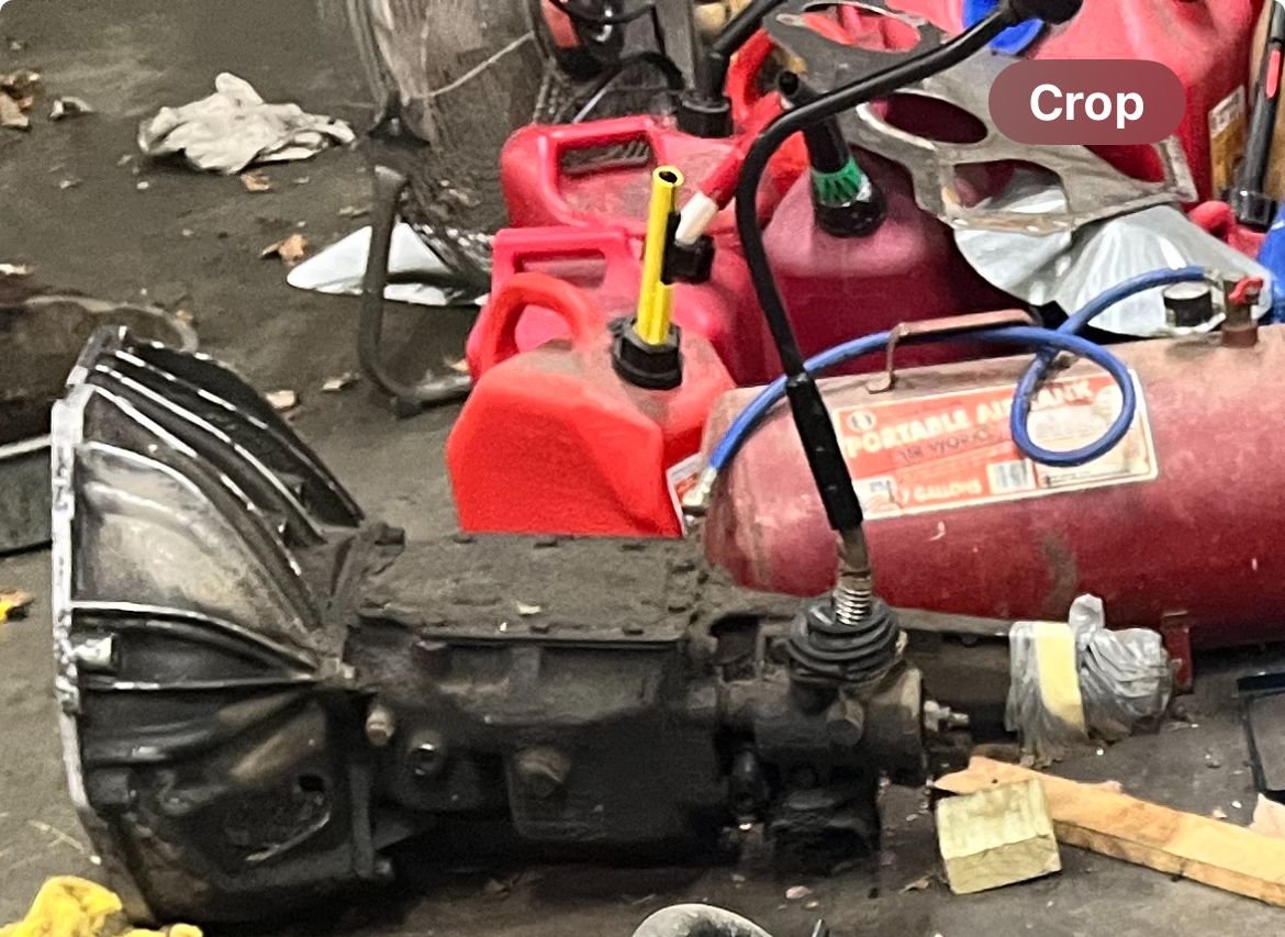

Which trans do you have?
--shifter on the top with the shifter mount part of the top cover?
--shifter behind the top cover on a turret, with a tube going forward?
(Both of those aluminum case)
--Shifter on the tailshaft with external linkage to shift arms on the side of the transmission?
Old Mar 31, 2024 | 09:51 PM
Old Mar 31, 2024 | 10:13 PM
85e150's Avatar
85e150
Joined: Apr 2004
Posts: 34,495
Likes: 2,809
https://www.drivetrain.com/parts-cat...-quote-the-cor
Several other sources as well.
I can't find a decent SROD rebuild video.
The old toploader performance 4 speed is similar, but the differences are such that you can't rely on that set of instructions to get an SROD right.
Have you ever rebuilt a transmission before? Like the idea of a new hobby? Got a spare $500 laying around?
