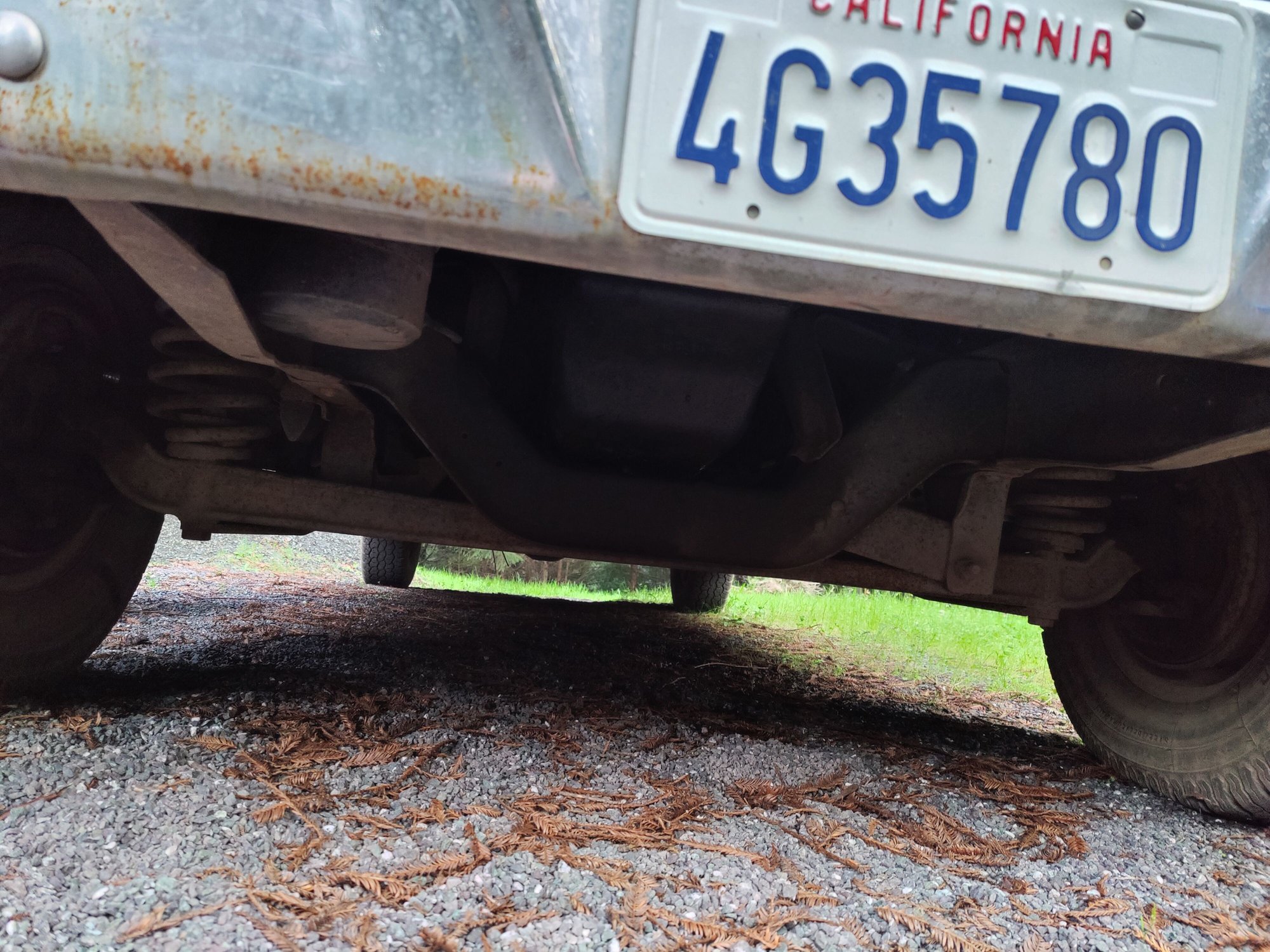

New subscriber, inherited truck. Not really a Ford guy as you can tell by my weapon in the background. Don't know much about this to tell the truth. 1971 F100, 6 cylinder, 3 on the tree, drum brakes all around. Motor probably needs a refresh as it loses oil pressure after driving a while, but excellent condition overall. Weird thing is it has a solid front axle, and here was I thinking Ford discontinued those sometime in the mid 60s. Included the plate for the VIN nerds.

Welcome to FTE!
Crawl under a little further and look a little closer.

That's not a solid axle. It's the Ford Twin I beam. I think they started that in 1966. Still a cool looking truck.

That is Twin "I" beam suspension. Basically, you get the strength of a solid axle but with a better ride. Ford used it for a long time. I believe other manufactures also used that type of suspension in some of their medium duty trucks.
The Twin I-Beam suspension was used in:
  • 1965-1984 Ford F-100 2WD
  • 1975-1996 Ford F-150 2WD
  • 1980-2016 Ford F-250/350 2WD
  • 1968-2014 Ford Econoline van

Nice truck to inherit, most aren't that lucky. B engine code represents the 300, the grill represents a 1970 model, I'll let the "vin nerds" see if my research is correct. It's over 50 years old and still around because it was cheap to maintain with simple backyard mechanic skills, I wonder if we can say that for late model weapons that will bankrupt you after a few expensive trips to the dealership. Hubcaps are incorrect for year, 1977+ lightweight aluminum, originals were painted steel. Probably needs an oil change too.
