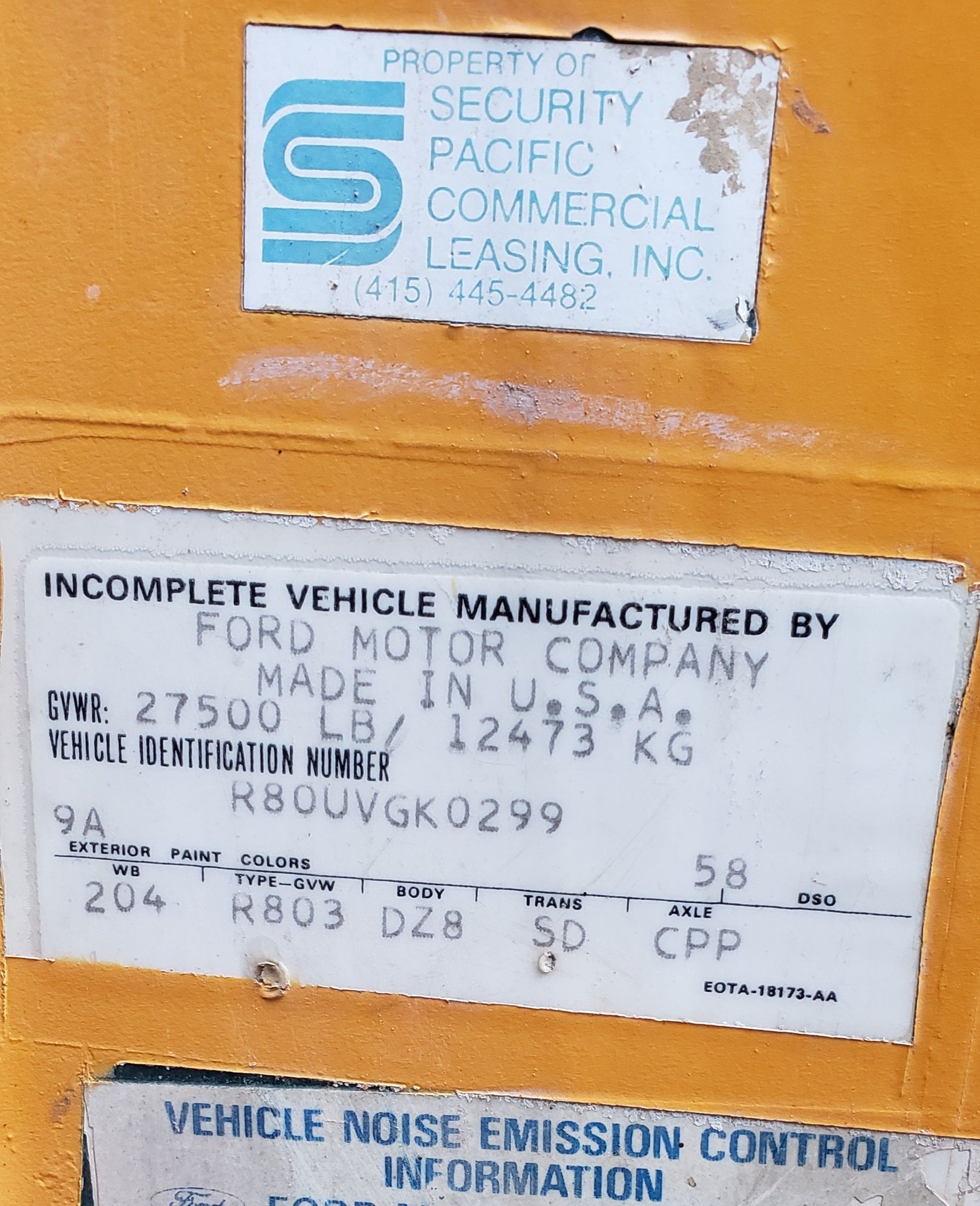

1980 L8000
I was hoping that "NumberDummy" could decode this for my L8000

Welcome to FTE!
R80 = LN800 diesel
U = Caterpillar 3208N or 3208T 8 cylinder 636/10.4 L displacement diesel engine
V = Kentucky Truck Plant
GK0299 = 1980 numerical series
9A = White
58 = Twin Cities District Sales Office
204 = 204 inch wheelbase
R803 = LN 800 diesel, 27,500 lbs GVWR
DZ8 = Standard cab. I do not have the full upholstery, seat type etc info.
SD = Spicer model CM-6052-A five speed direct transmission.
CPP
CP = Eaton model 23221 two speed rear axle, 23,000 lbs capacity, 5.43/7.39 ratios
P = Rockwell (Timken) model FF-903 front axle, 12,000 lbs capacity with power steering.
