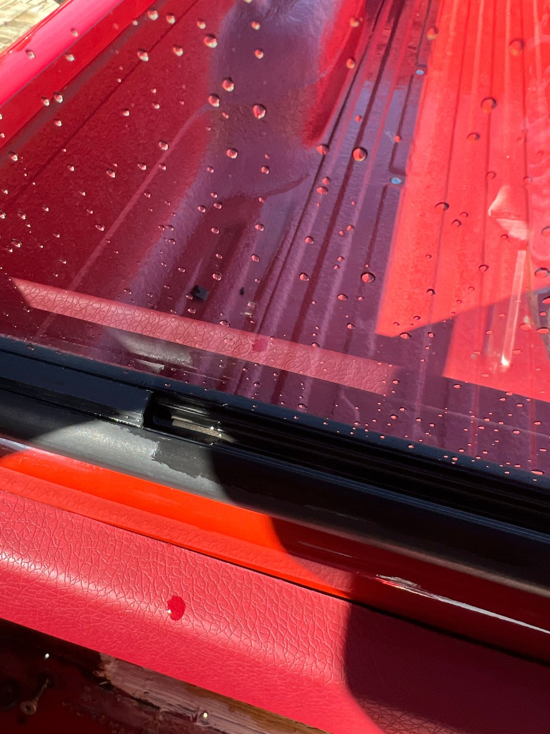

That was the major source of water for me. Ran the hose test and when it hit the sliding rear window it shot in through the bottom passenger corner where the sliding glass meets the solid glass. Preliminary online searches and I can’t find a replacement strip for under the windows.
Does anyone know where to buy this rubber piece or have a part number??

So it was a trail of wetness leading from a rear slider in your super cab to the passenger door at the sill?

Yep, water flows downhill and that’s the lowest spot. There was a little bit of water seeping in from under the door as well but new door seals should clean that up.
