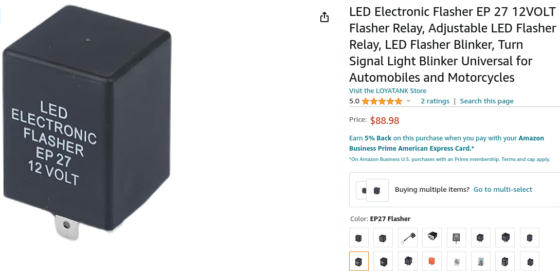

Bought a 2005 XLT that has older after market front & rear LED lights. The turn signals are doing the hyper fast flashing that LEDs do sometimes. Is their an easy fix?

install an EP27 flasher relay.

That will do the trick then?
I'll get it today., thank you.

If that does not work, go back to regular bulbs. Also subscribed to have that repay part # and pic location handy. So thanks for the part # and pic location.
