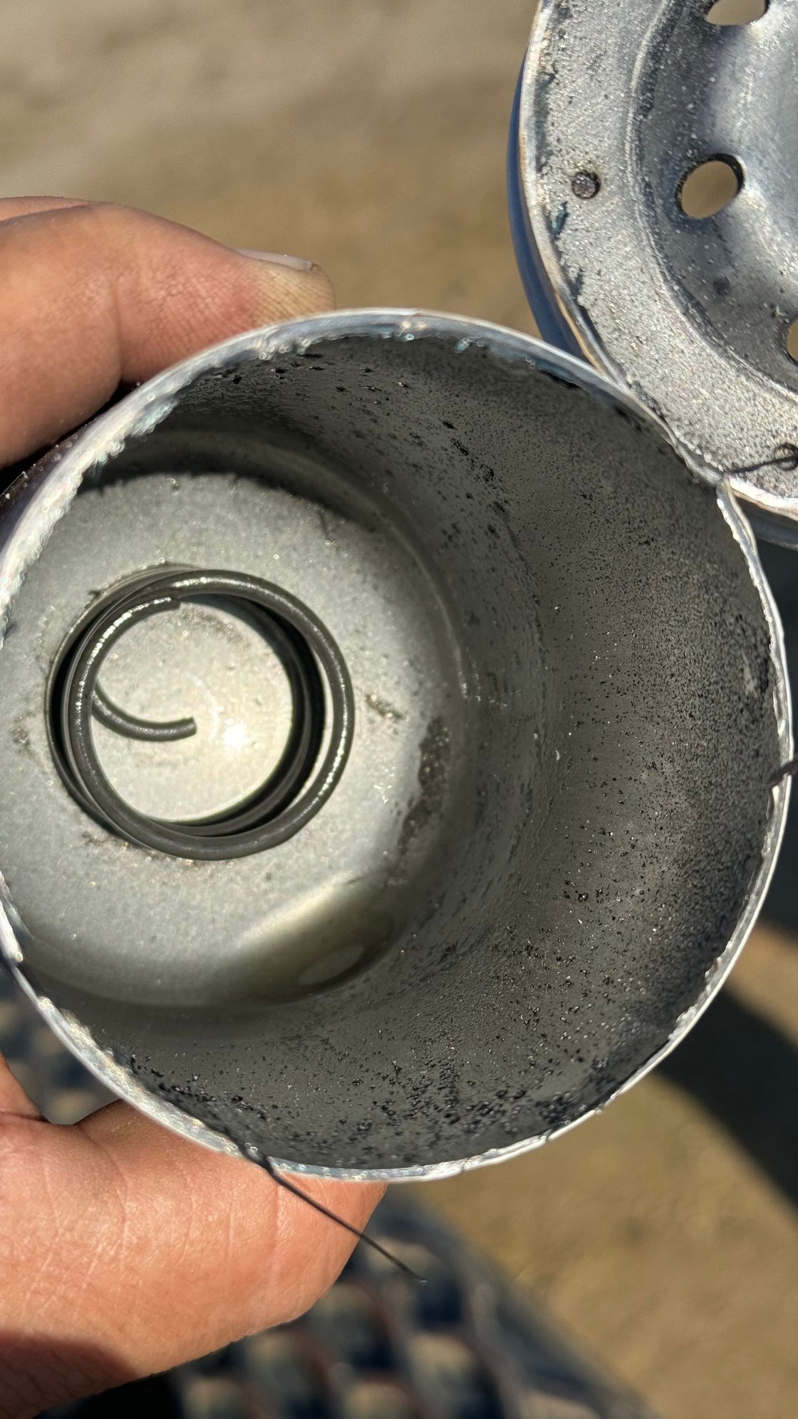

While on a visit in March 24 my friends truck died on the freeway. We loaded him on a trailer and got him home. I diagnosed the truck. Crank but no start 216psi fuel pressure to start (commanded 4200) P087 DTC (low fuel pressure). Tank pump checked ok. Pulled the tank filter clean and 2 quarts of fuel also clean.
Pulled the DPK filter
Glitter (photo was out of focus)
Drained DPK filter
Glitter
Cut the filter apart
You guessed it. GLITTER
I did not have time to get into the rest of the fuel system yet, but I am expecting the DPK saved the reset of the fuel system.
I will be installing a DCR and retaining the DPK “return line” filter as my friend wants it.
So a very long post for the short answer is the cost of a DPK worth it.
I will say yes most definitely.
I will update this post with relative information on the condition of the fuel system as I take it apart.
