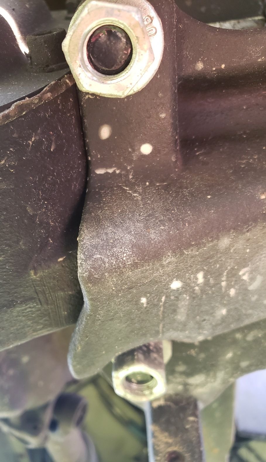

I just went out and took pictures of mine, and you are correct, the driver side bolts should be a bit longer. My apologies for my bad memory. They have about 1/8" of nut thread still showing. The passenger side is perfect though. However, this is with the bottom leafs removed. Therefore, I believe this recipe should be changed to use 9.5" front U-bolts! You can always cut them off if they are too long.
For the record, the rear U-bolts are plenty long enough.
Front driver side:
Front passenger side:

That's exactly how mine look. I do have the 9 1/2" on hand , ordered them after realizing the problem. But I haven't installed them yet because I'm trying to find time to install the pair of 4.10 axles I picked up. I am going to reinstall the bottom leaves as well at that time and see how I like the ride.
But yes, based on my experience I think the recipe should state 9.5" ubolts up front as well. Other than that, the pirate recipe lift has been the best thing I've done to my ex in the 20 years I've had it.
