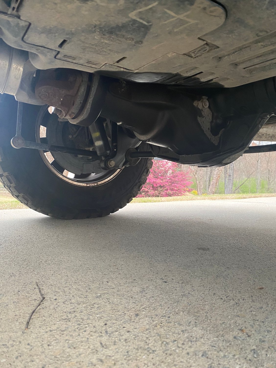

800 miles from home towing my camper and my rear pinion seal started leaking. It’s not gushing but slinging oil around, do y’all think I can make it home or need no rush into dealership. 2019 f250 6.7l with only 32k and the sterling 10.5. I am kind of at a loss why at such low miles.

Get some gear oil and put it in and see how low. Carry a couple extra and get to you hone area to get it taken care of.
I've done that on a big truck, inconvenient but doesn't ruin the gears and get back home.

Are sure that there was none of this pre-trip? If it were me, while following the check level/fill if needed advice that was already mentioned, I'd get a can of brake cleaner and wash off the oily area as best as possible. Then you might be able to better assess the severity of the leak. Like was already said, a little oil spreads a long way.

Park the truck on a hill facing downhill so the fluid sits up against the pinion seal and come back in an hour to see if its even dripping. If its just a weep id check fluid level and run it home checking every 50 miles or so just incase. Mine was done under warranty around 5800mi. I waited while they did it as its only a 2 hour job.

I stopped at a dealer in the area and they told me 3 weeks out. But then the service manager heard me talking and came out to look and said he was ordering parts and would get me in on Monday. Said if it was seeping he’d send me on my way but then his mechanic took a look and said it needed to be addressed asap.

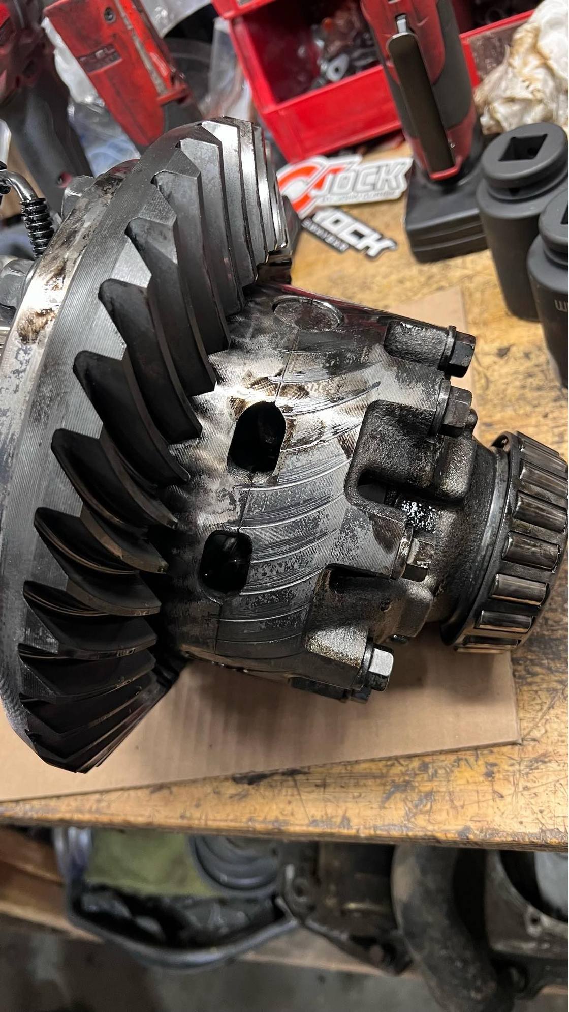

Originally Posted by number9xd
My truck had pinion seal leak last year. Dealer scheduled a week or so out, and had it for couple days to replace the seal. It’s not leaked since but now has gear whine on coast, which is usually a sign of low pinion preload.
For sure keep it topped off and get it fixed, but likely won’t get fixed quick if you just pull into a dealership somewhere.
I had my pinion seal replaced, soon as i left the dealer heard the whine when i took my foot of the accelerator. That is the damage to my locker that was discovered by the shop that did my 4.30 gears.
Get the whine taken care of asap.
