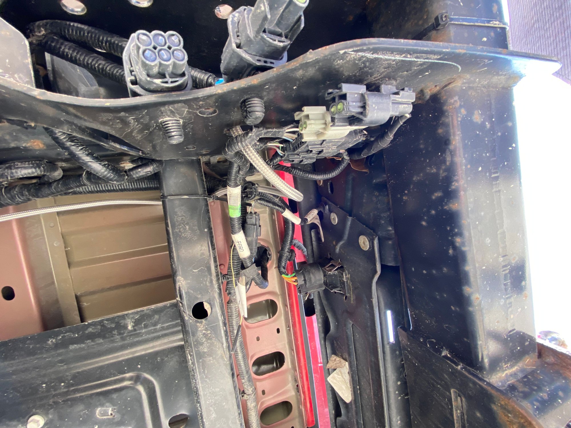

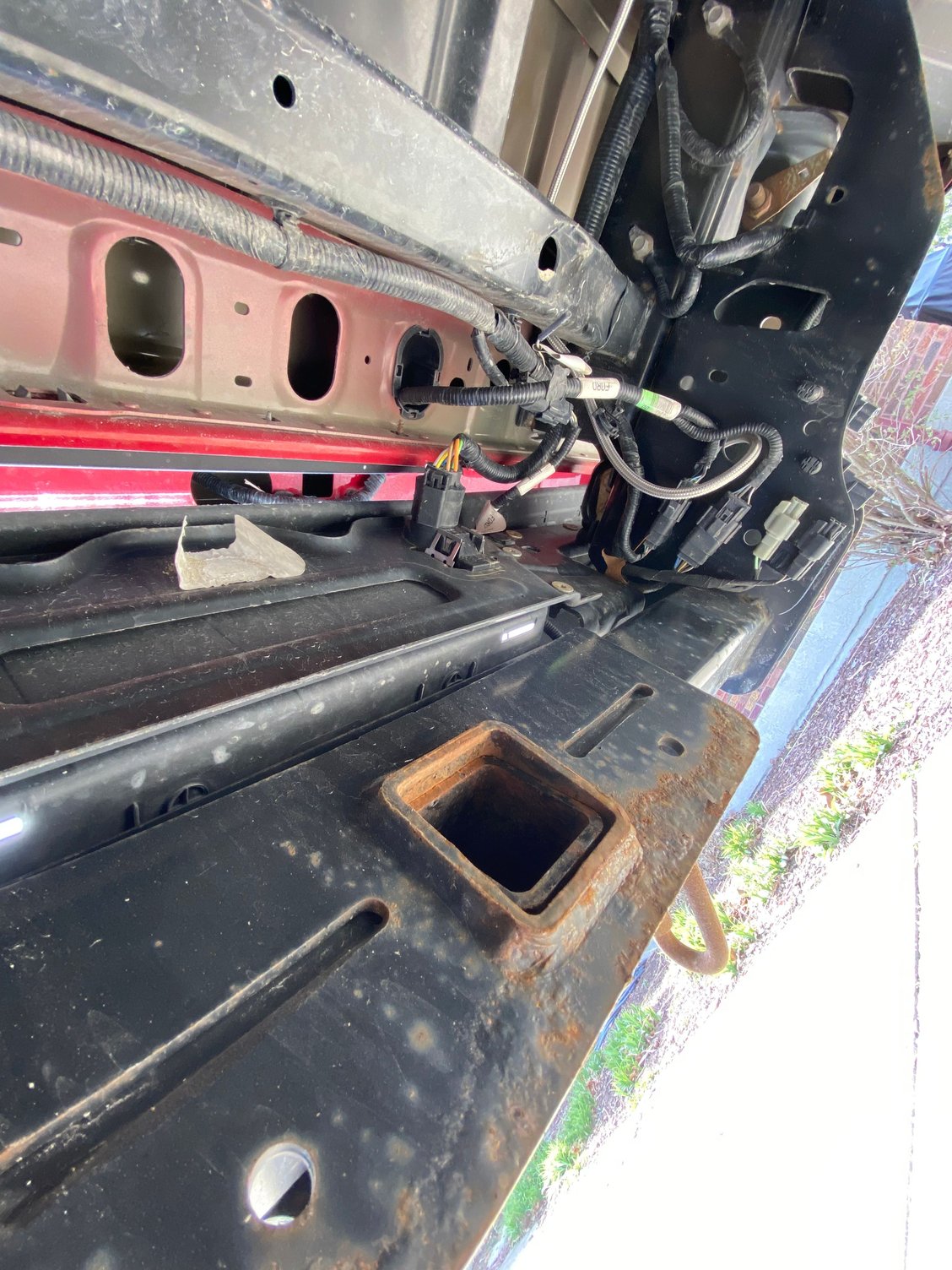

I don't see the plug under my truck. Or am I looking in the wrong place?

See page 5 of the attached document. Your pics are inconclusive, but the harness was there on both my 2019 XLT Premium and my 2023 Lariat.
