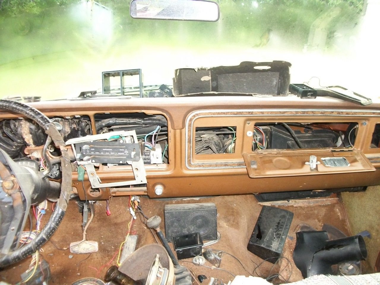

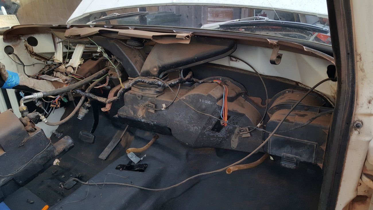

To get the plastic defrost duct out you pretty much need to remove the dash. Yes screws hold it in place, but all the other stuff behind the dash is right on it. A/C truck below.

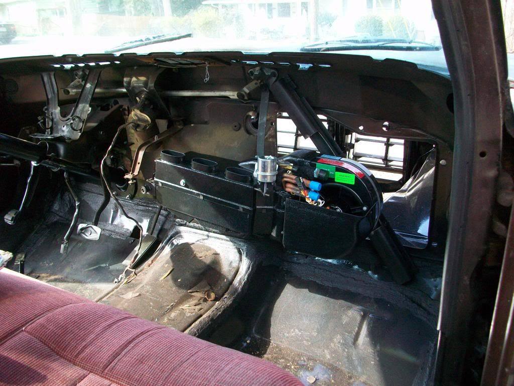

I believe this one is getting aftermarket a/c??
Fresh air vent and heat only box.

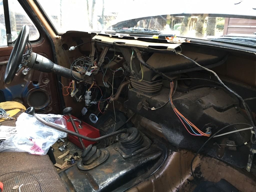

Another heater only box.
Mouse built a house (more like a condo) in the duct work.

Great pictures educational my situation. Looks just like the last picture part everywhere it almost comes The cluster hole is half out the glove box hole I had to walk away. I will analyze later and report back.
