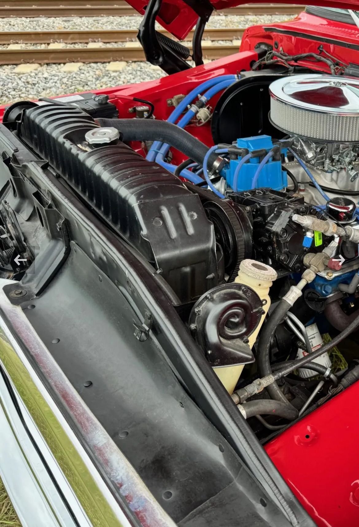

Post up some pictures especially of the coolant reservoir/recovery tank.

None of them ever had a reservoir. I assume he means the radiator.
The fluid level should be an inch or so below the cap. if you fill it to the top it will puke it out the overflow hose to the level it wants when it's hot.

Deadbuck's Avatar
Deadbuck
Joined: Apr 2018
Posts: 286
Likes: 40

I am a big fan of the "park it on a steep hill, nose up" method of bleeding air from the coolant system. Looks like you have the heavy duty radiator which holds alot of coolant. 6 Gallons total capacity i believe. Might not have been full. I agree with 440sixpack in that it should level out. Another tell tale sign of low coolant or a stuck air bubble is a non functioning heater. Check your heat, keep an eye on the oil, watch your temp gauge.
