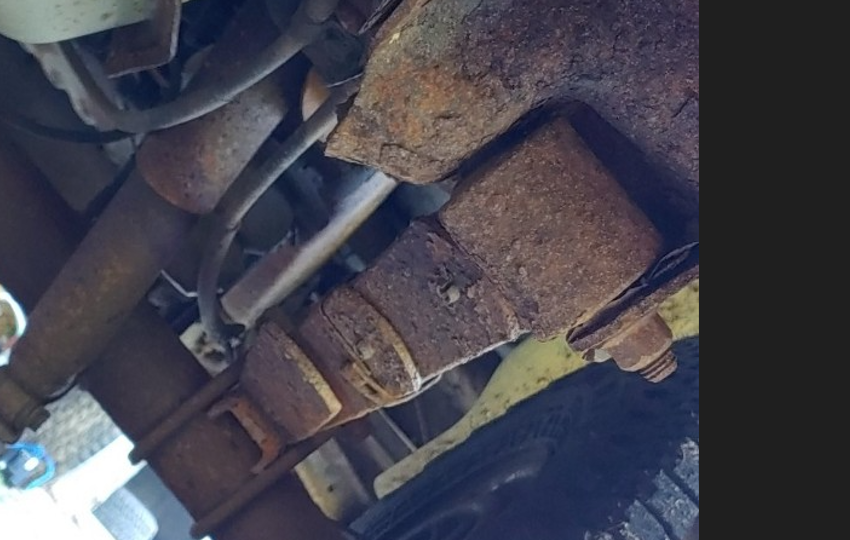

Well, I guess that's good that I'm not missing them. Sometimes when turning, I hear a popping sound under the bed, haven't been able to find the cause. The bottom leaf on right side is shifted a bit or not in line with the rest of the leafs, but I don't guess the clips matter since it doesn't look like they go around that leaf anyway. Wondering why that leaf would have shifted around and if that could be the cause for the popping.

Could be hearing a broken spring popping. It ishard to tell without jacking it up and separating the springs.

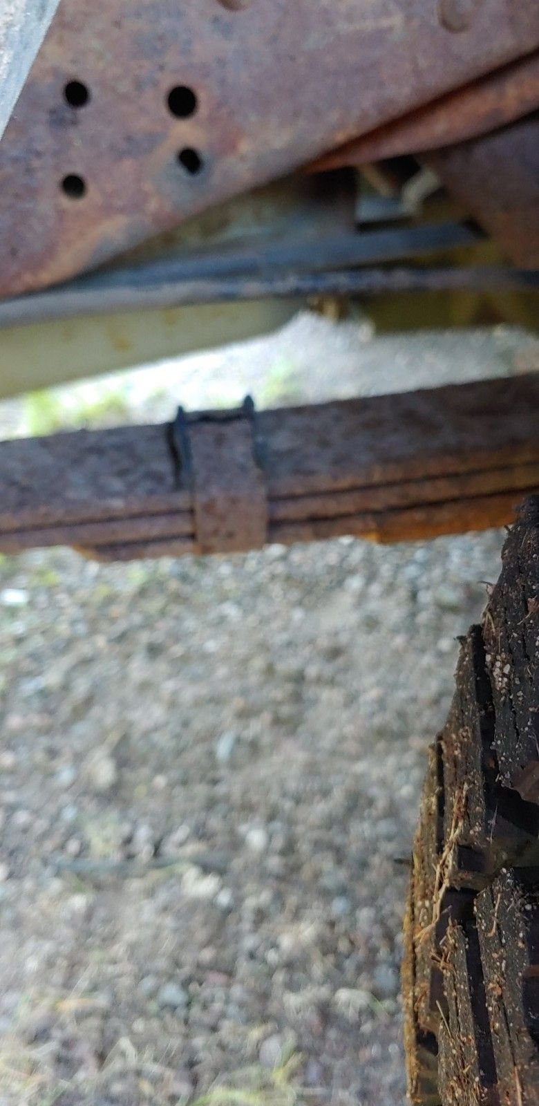

are you talking about these? If your pack is as small and weak as mine is here, it probably only has them on the front because the springs need to flatten out a lot more under load vs having a larger pack and the clips would probably fall off with such a change in sspring Or, they had them and thats why they are no loinger there
It seems to me the function of the clips is to prevent what you see here( my springs are bent and old and rusty so im not surprised!) and also to prevent "fanning" which is when they separate from eachother but distance from eachother like your fingers in an open hand instead of touching like when together.

Yes! That's exactly what I'm talking about. Mine are also fanning. Have never had to separate leafs before, I guess it's pretty straightforward?
