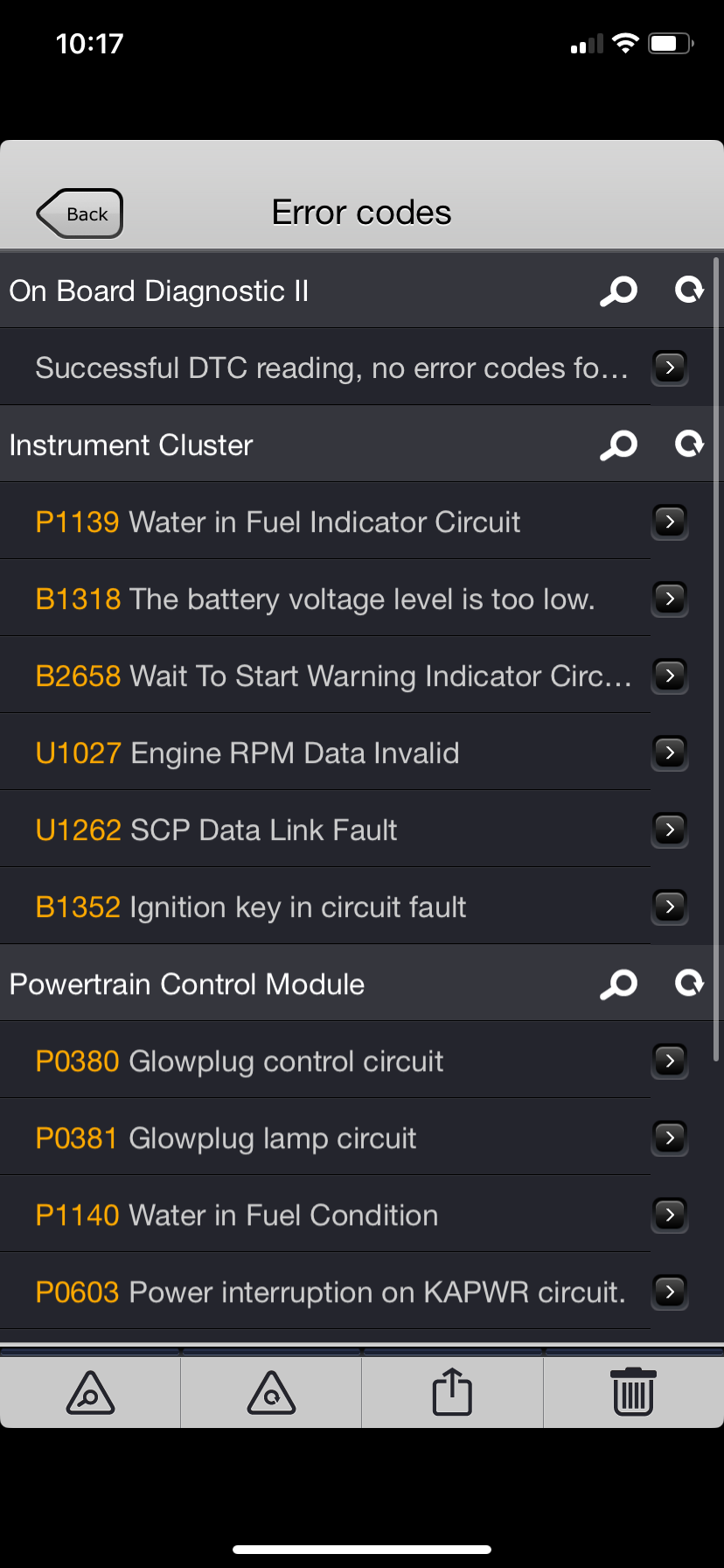

Update my truck turns on now but I have an issue where it sounds rough it saids it has a water in fuel (which it has never said until now and engine light on but no codes show up on my reader or on oriellys reader. I’m getting a Bluetooth wifi reader for FORScan so I can hopefully see something but never seen no scans show up with an obvious light on. Any ideas what’s going on it doesn’t sound rough idling only when driving no more white smoke though .

Have you open the fuel bowl to see if there is actually water there? You could also slide the bowl drain hose off and put a hose of your own in its place. Then put the hose in a clear jug and open the valve. Turn on the key and see what comes out.

Have you cleared the codes and this is what continues to come up? That's an interesting list of codes there. Kind of all over the map there. Which makes me think gremlin. Since you've got a battery voltage code and a power interruption code I'd probably start at the batteries. Disconnect them both from the truck and each other to verify voltage. Both should read the exact same and be no lower than 12.4v. If not charge them separately and recheck. Once that's squared I'd move on to all the main power connections making sure they are clean and tight. If that doesn't get you anywhere then on to the harness. Since you've recently done work on the injectors I'd start at the 42 pin going over everything with a fine toothed comb, looking for a sign of damage or just suspicious in general.

Agreed. Those are a lot of random codes.
I'd definitely check all fluids, do a visual to see if anything looks awry, and re-check connections...especially the 42-pin (I would disconnect it, check pins, then make sure it is reconnected securely).
Once that's done I would clear all codes and start it again to see what shows up. Hopefully it's a smaller list that points to somewhere to start looking.

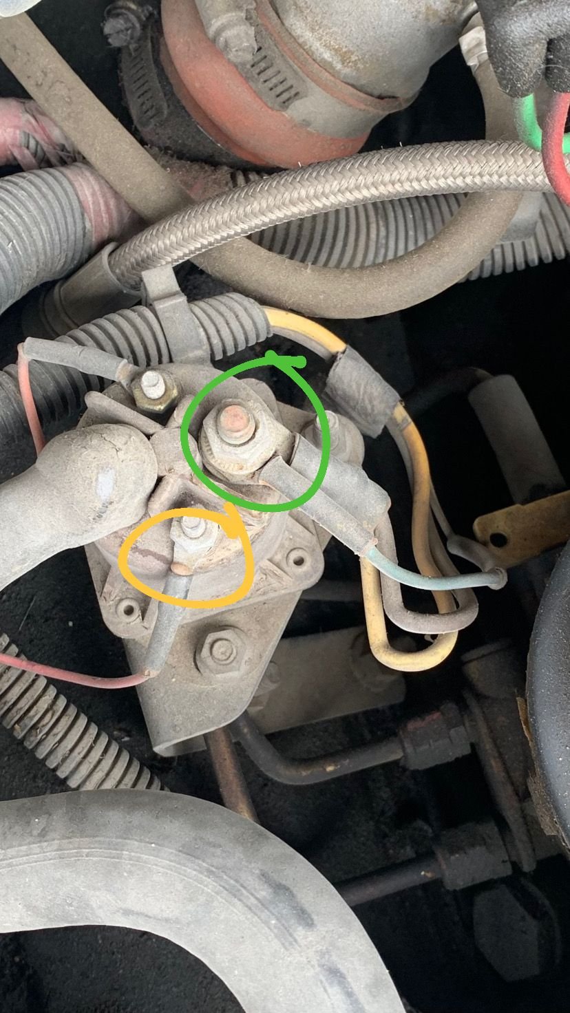

cleared some codes and noticed a few things
-3 wires that connected to glow plug relay were taped up as shown above with green circle and another single wire on the yellow circle (picture is an example took the picture from my other 7.3)
-noticed a fluid in the female end of the valve cover glow plug harness
-what I suspect to be wif sensor with a aluminum line with a rubber end meeting with the fuel filter was not connected
​​​​​​-diagnosed the glow plug relay right terminal or green circle in the picture above had no power with the key on motor off

Was the aluminum line coming in from the rear right below a yellow lever arm? I ask because what you describe sounds like the fuel bowl drain tube.
The GPR will cycle based on engine oil temp for anywhere between 0-120 seconds, the 0 only happening with temps over 140 I believe. So if you turn the key and get no reaction from the relay then something is up for sure. Here's the pinpoint test for the glow plug circuit from the tech section. It should help you trace the problem so you don't buy unnecessary parts.
