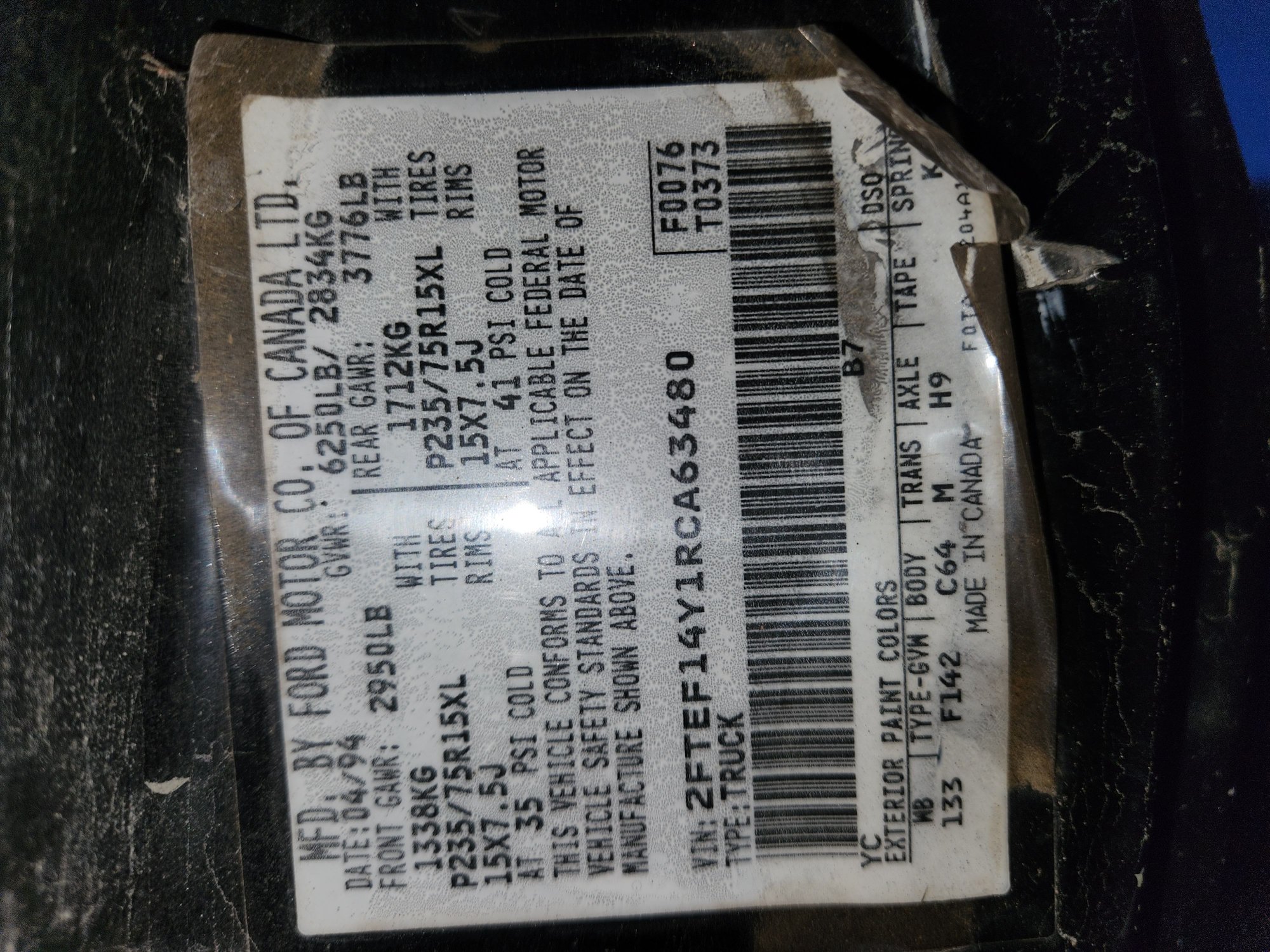

5th gear 100kms (60mph) 3200 rpm
factory engine was the 300i6
This is the door tag.
Is the tachometer you are usimg the factory dash tach for the 300? I wonder if the 6 cylinder tach is reading the 8 cylinder signal wrong and giving a false reading. That or the tach is just malfunctioning. Because as stated before. There is no way with the gears you say you have that the speedometer and tach are both correct.

I ran the Vin in your picture. It comes back as 3.08 gears and 4x4.... which the door tag shows 3.55s so that is contradictory. Is the truck in low range and you don't realize it? I mean I think 3200 in 5th and low is like 55 or something.
