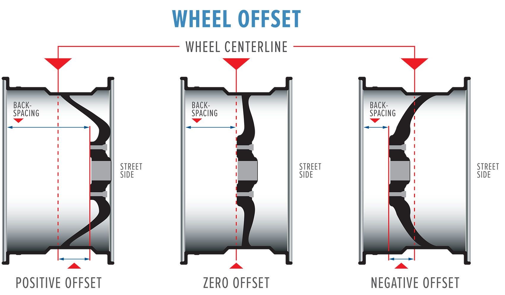

Just FYI, offset and backspacing are two different things and not interchangeable terms. Depending on wheel design and rim width you can have a wheel with zero offset that will have huge backspacing. The below picture explains it better (image courtesy of a google image search).

Yes, I understand the difference that's why asked; "Does anyone know, for sure, the OFFSET or Back Spacing of a 2005 Excursion", either one will give me the info I'm looking for (although the Offset would be better)
