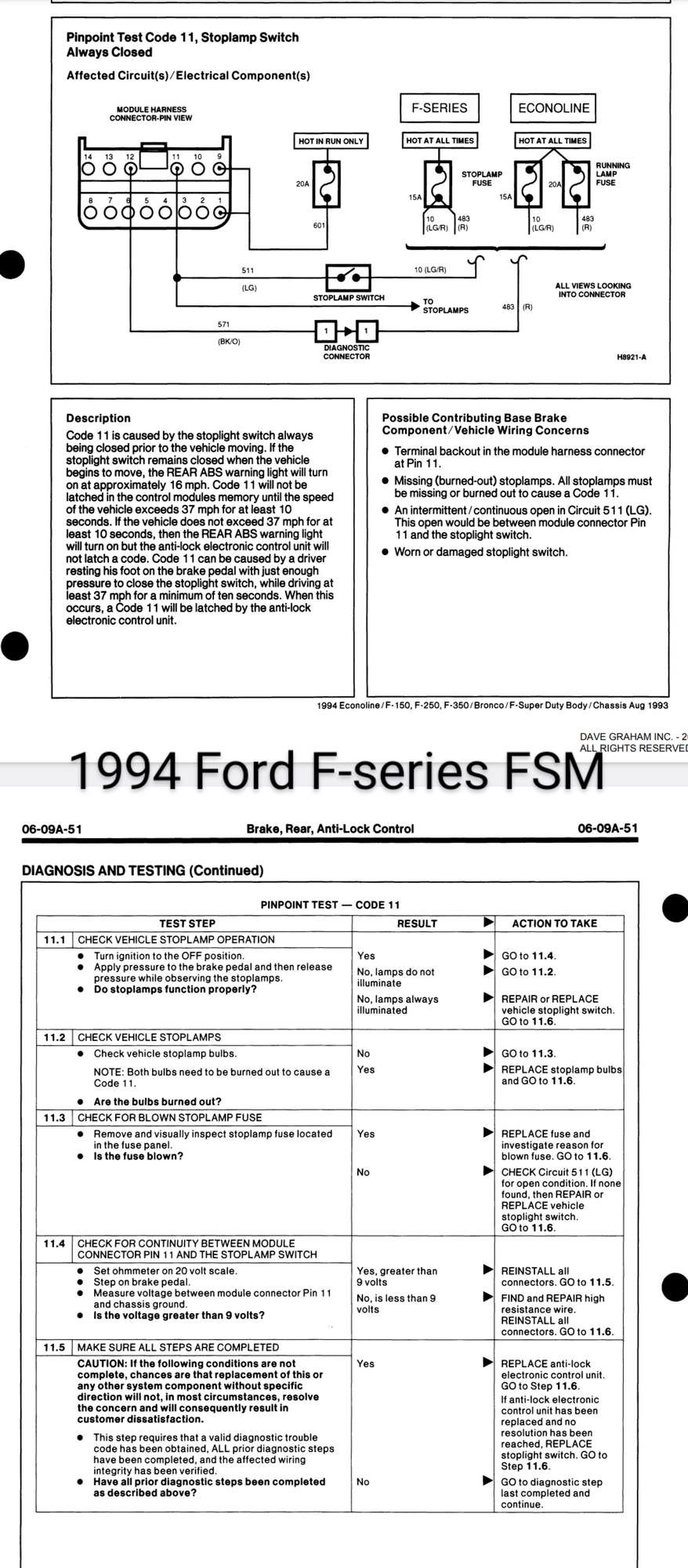

I still have the “Rear Antilock” light come on, but only when I get over 35mph. Code reads “stop lamp switch malfunction”
Could this have something to do with my issue? I don’t think it could but it seems like it’s related…….!!!!!

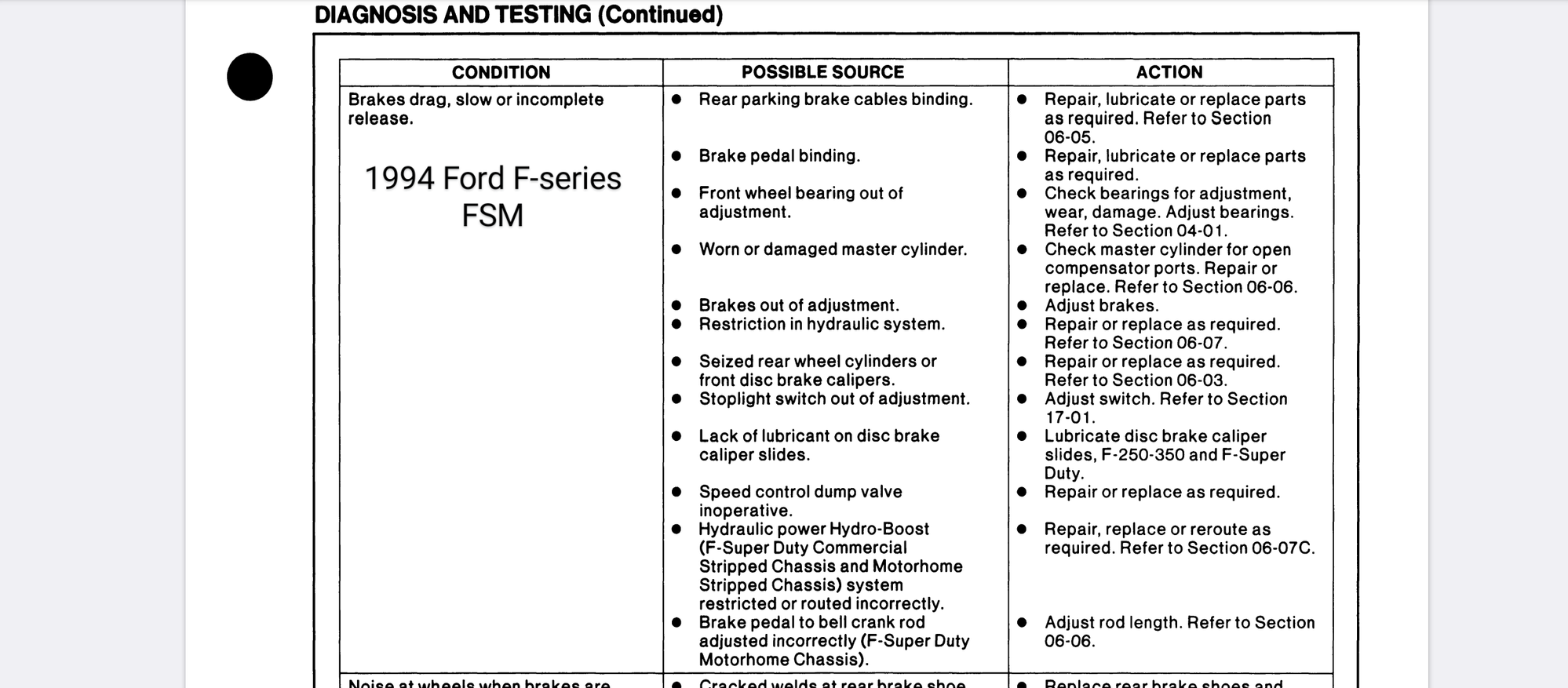

How are your wheel bearings? Loose wheel bearings can cause brake drag.
Reading the ford factory service manual. It also suggest checking the stop light switch on the brake pedal for proper installation.

I agree. It shouldn't have an effect on the brake operation, but the FSM suggest looking at it and the OP has a RABS trouble codes for stop lights. Maybe they're related. Perhaps the switch is rotating and jamming on something, causing the brakes to no fully release. That would cause his abs code and dragging brakes.

The code I get is “stop lamp switch malfunction” but my brake lights are perfectly operable…

It's just a cotter pin to remove the stop light switch from the pedal. Try removing it and drive it around the block a few times.
