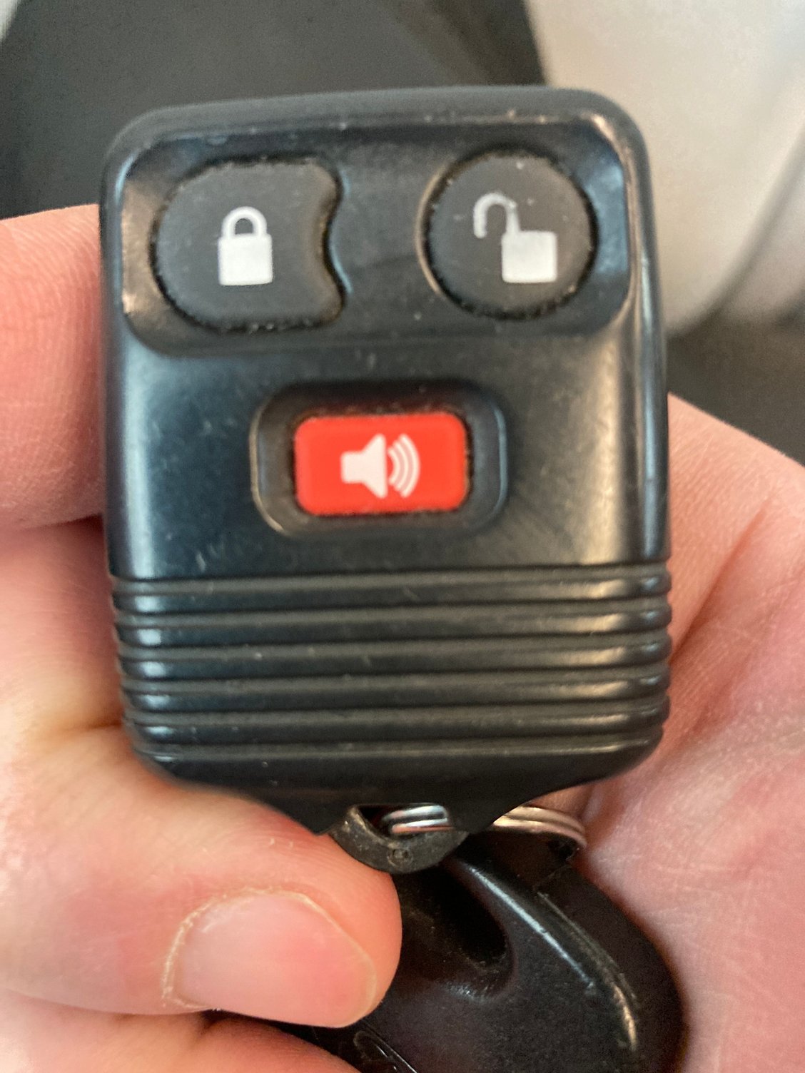

Originally Posted by 05ExcurBros
Thanks for the response. The back of the alarm box say Ford Motor Company?? I use to work valet many many years ago. They use to put the button on the steering column etc. I can find it. It like you said I probably can try holding a button down to see if it takes it self out of the mode it is in.
Send a picture of the front of the remote. You may have the accessory alarm from Ford. It perfectly integrates with the truck and may use the standard RKE remote or a different remote if it has remote start.
