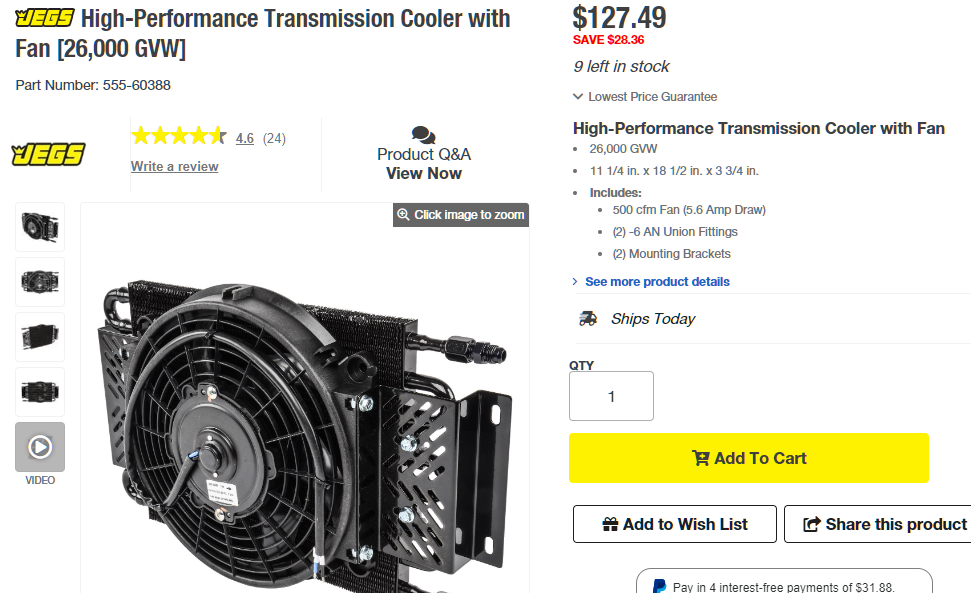

your 4r75 transmission will be happier with a cooling upgrade as well. I don’t think you got the big cooler with the 4.6. Looking for the HD cooler for a 5.4 truck would be worthwhile.

Luckily, one of the smart things I did do was...after I purchased the trailer I had this installed on the truck:
https://www.jegs.com/i/JEGS+Performa...60388/10002/-1
