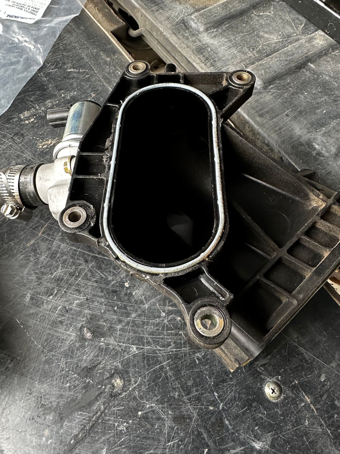

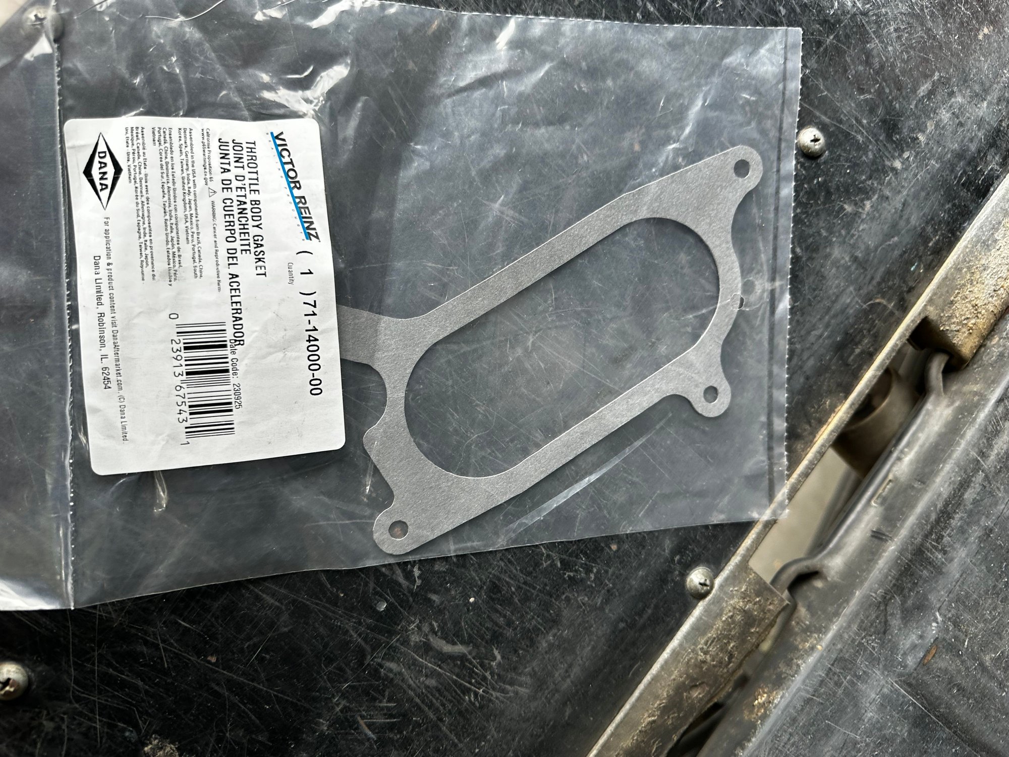

Bad news found that ford did not put the gasket back on that mates up with the throttle body and intake manifold, its been running rich for so long now that I fixed it myself, went to change the oil and complete glitter party. Guessing all the unburned fuel destroyed my internals.

that o=ring is the gasket for the plastic housing, what i do see is the broken out section of the housing that fails to seat the o-ring properly,
the gasket you show will help seal a bit better but a new housing should be used,
glitter in the oil? SORRY but i'd be checking the prices on long blocks and labor before going any deeper ,

I thought that too it was old rtv like someone was in there before. Yeah trading it in this morning I’m over it lol

good luck man. your right someone was in it, tried to play penny pincher with RTV by doing a hack job .
