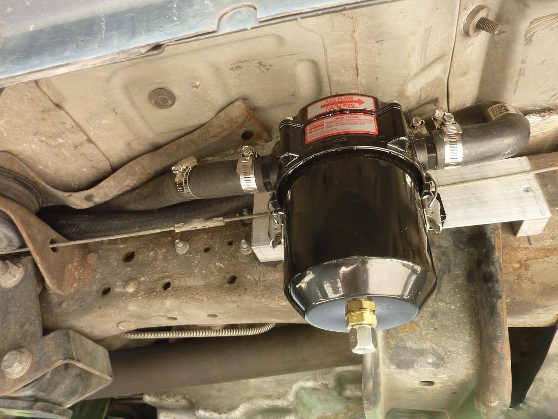

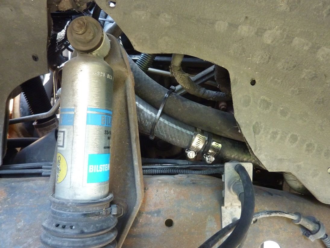

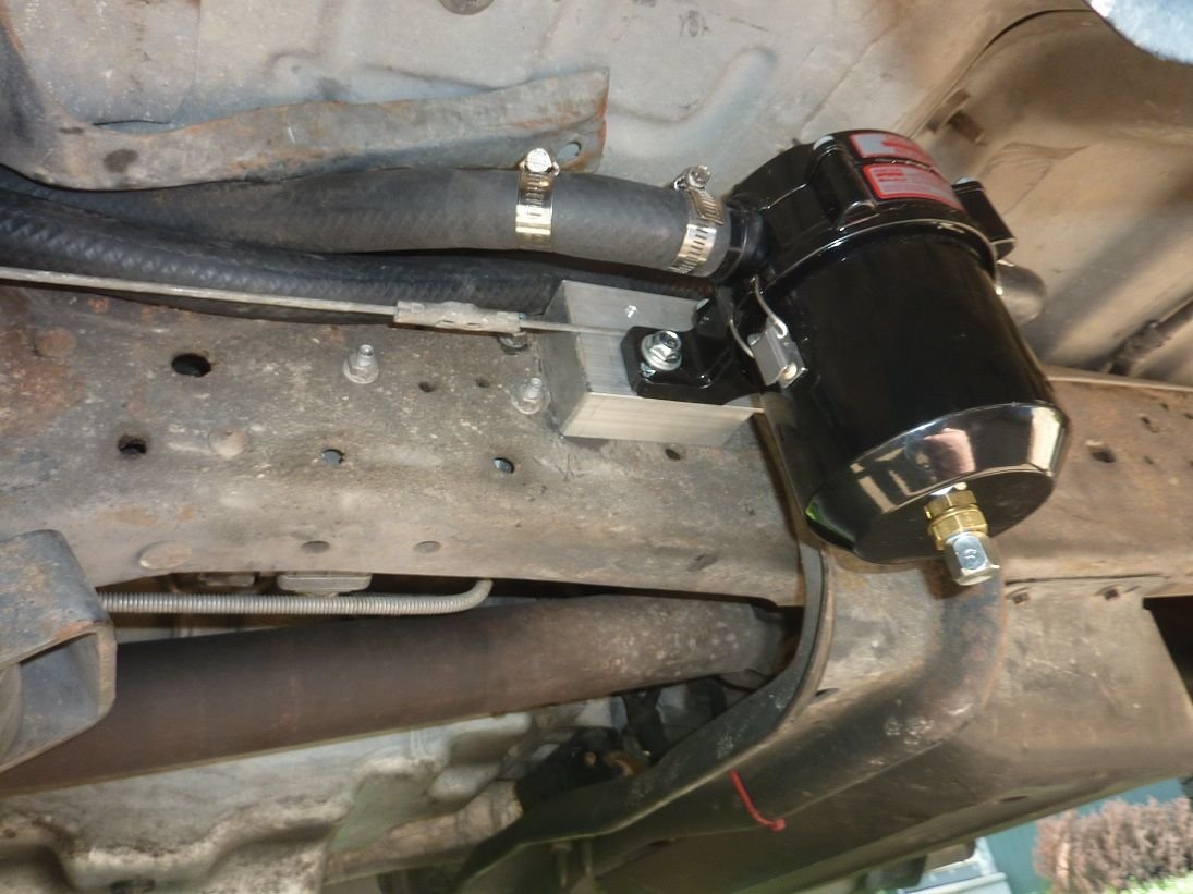

Had time today to get it all plumbed in:

Just out of curiosity, how much did you guys pay for these filter canisters? The ones I found are pretty pricy on EBay. Racor CV4500, correct?

wow! For that price I’ll let the oil drip on the ground! Are there any other filter solutions you’ve come across?
