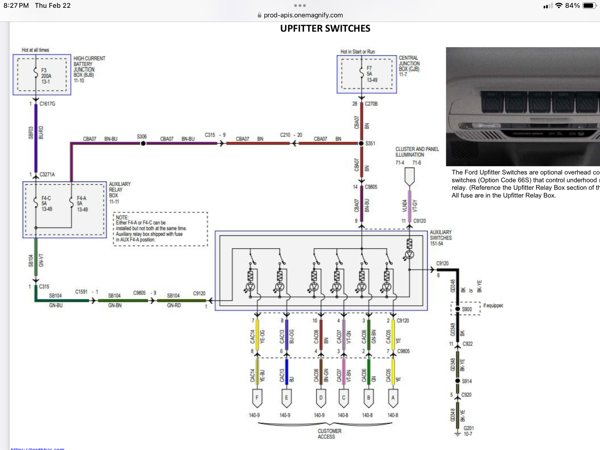

Hi guys! I have a 2023 Ford f-550 super duty.
It has upfitter switches. I bought a dual row lightbar that draws 11.6 amps according to the mfg(Aurora). I have 6 switches. My question is which switch should I use?
I have no idea how many amps each switch is capable of. Thx.

Any of them will work with that amperage.

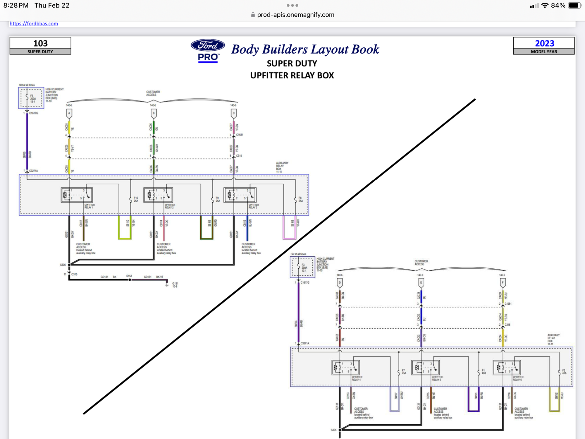

5 and 6 are the highest rated amperage, and they are also the switches that can be setup to work with the key off, if you need that.
But, yes, all are rated high enough for an 11.6 amp draw.

This is what I used on my 2023 F350. ASSUME the 550 is the same. 25 amp 1-4, 40 amp 5&6.
