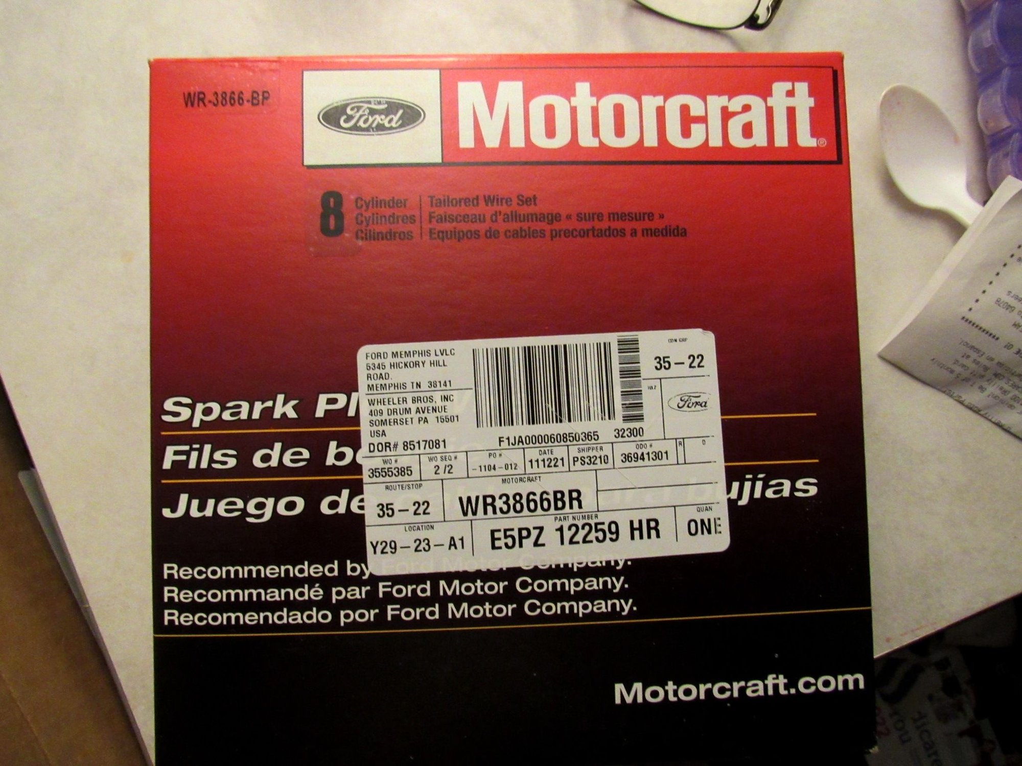

Here's my choice for spark plugs and spark plug wires.
I've never cared for colored spark plug wires.
I just like the way they look.

what about the gap ? I read 0,043 inch is it correct ?
