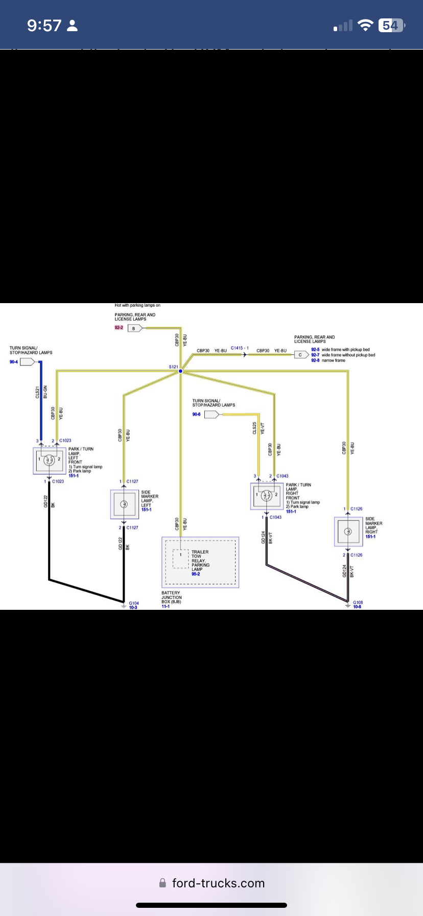

I’d way rather use the existing switch rather than my upfitter switch. Putting a inline fuse is definitely going to be what I’m going to do so I don’t fry anything. I don’t have any of the schematics or a wiring diagram which would make fixing this issue so much simpler. I’ve been going off of random YouTube videos and really hard to read google images. You would think since ford had this bright idea they’d throw a guy a bone! I really like your idea of an external relay for many reasons, especially being able to use my factory switch and not wasting one of my upfitters! If I find any wiring diagrams I’ll send them to you!

I just found these going trough a different forum, hopefully these help!
