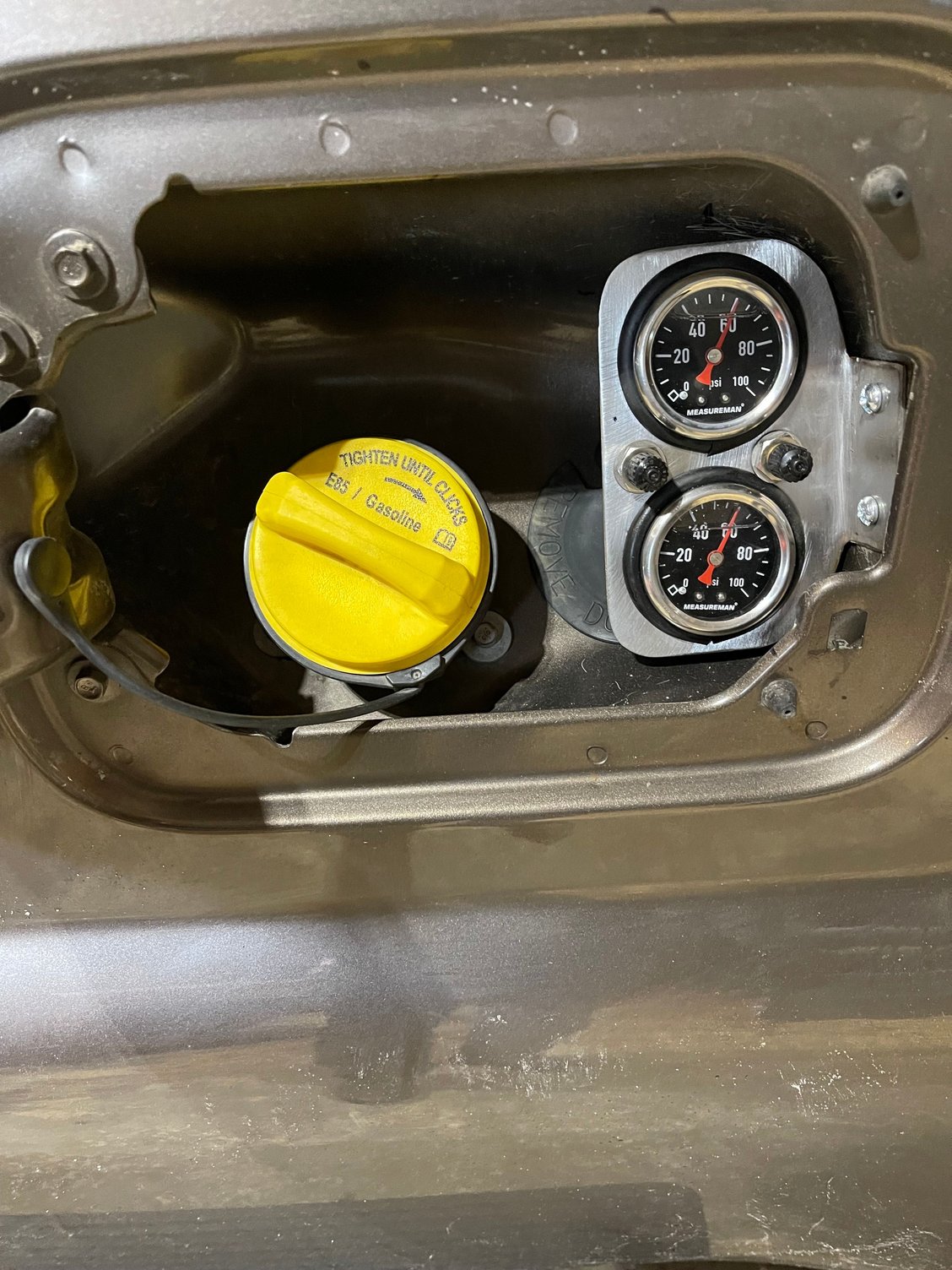

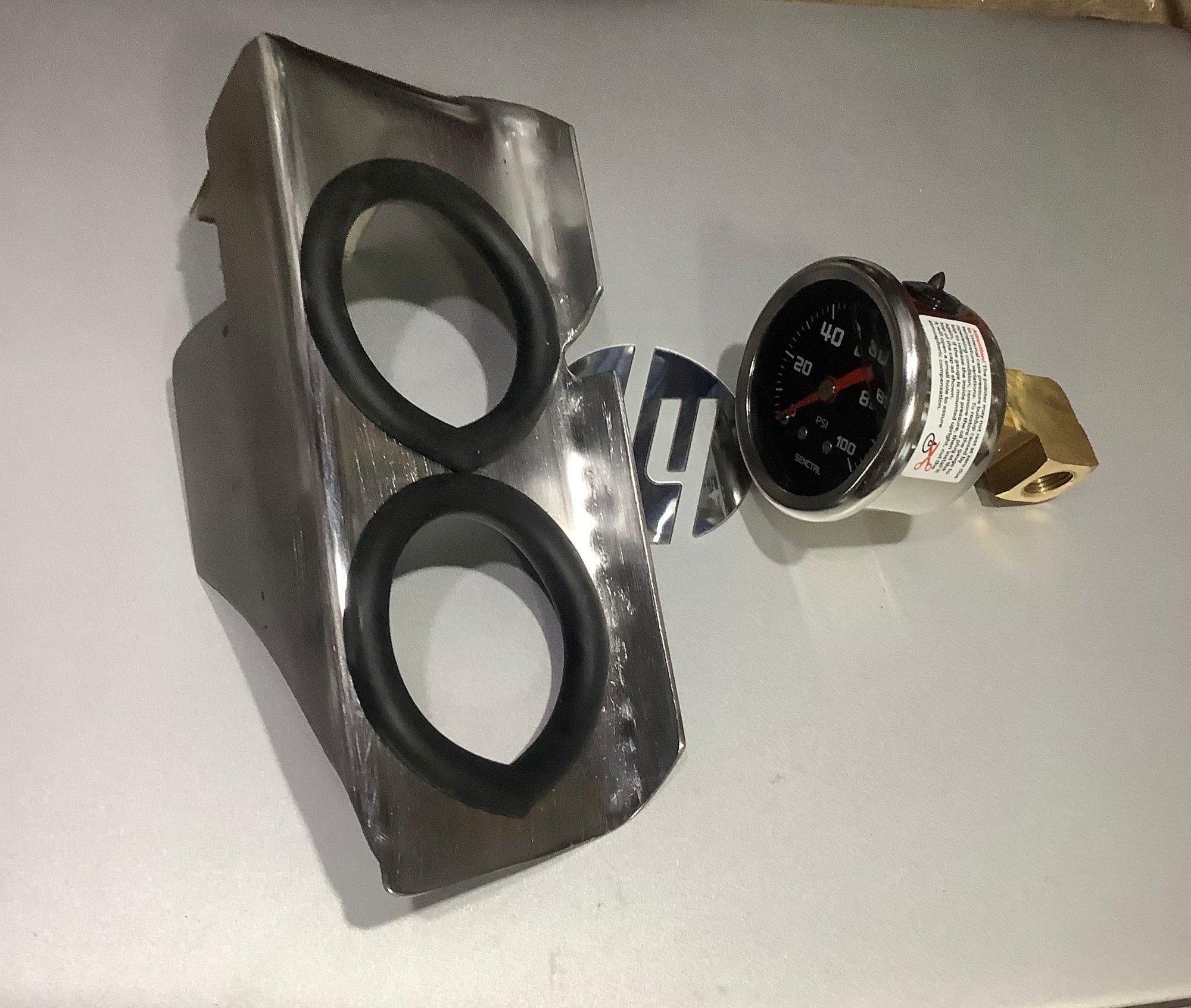

On my 2016 I put them in the gas fill compartment. Doing the same on my 2023 when I put them on in the spring. Have the gauge holder made already.
I like that location better than the license plate. Plus, with no DEF I have plenty of room in there.
Seemed to be more room in the 2016. On the 2023, the bracket will have a small side on the left side to mount the air lines as the air lines will be mounted to the left side, parallel to the truck and will coming into the compartment from the right. There is a metal support behind the compartment making it impossible to come in from the back. Had to trim a little off the vent cap to get the needed room for the bottom gauge. A little more complicated than on the 2016 but very doable. Will post pics when done, but it will be several months.

but i like the guages the user above did.
