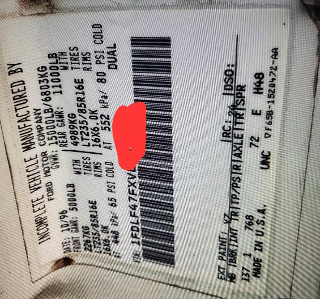

putting a bed on a c&c frame isnt my question. I am wondering how its possible to have a production factory long bed sitting on a 137" wb frame, without a 4" gap between the cab and bed

it has L-brackets bolted to the frame that the bed then bolts to. I knew it had to have those to put a factory bed on it. My question is how is it possible to have no 4" gap between the cab and bed on a 137" wheelbase? the only thing I can think of is that someone moved the rear axle and springs/perches forward 4".....unless there was some speical 137" wheelbase 4" longer bed that was some special option from the factory. Ive never heard of one, but Ive never really looked at super duty trucks before either. If this was a manual truck, Id buy it. As its an auto, im considering it.

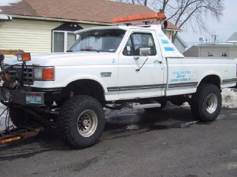

someone could also have made the bed 4 inches longer in front.
not that hard to do if you know what you are doing.
i used to make custom beds for cab chassis trucks.
my F-SuperDuty was setup for an 8 foot utility body, so the pickup bed looks stock after making tabs to bolt the bed to.
