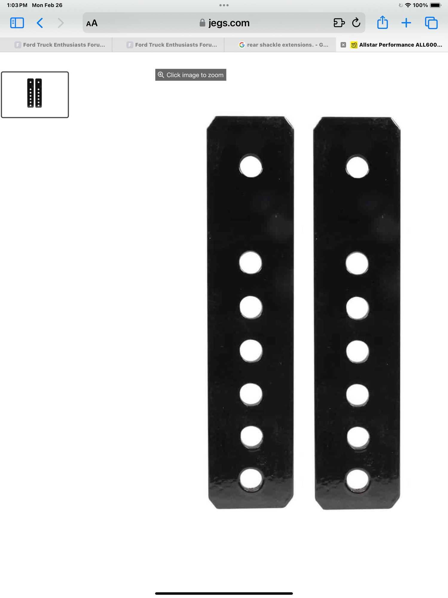

I have a 1957 F 100 I put a cv front axle in and I am running a 9" in the rear. I flipped the rear axle and C notched the frame and she sits a little to low in the rear. What can I do to get the back end up a little? Thanks

Try putting a longer shackle in the back. When I was a kid we'd do it to raise the rear ends up to give our stuff a raked look. You use to be be able to get those shackles everywhere but now they're probably lots harder to find.

Yup that should work. I remember raising my 70 Nova with a set.

Thanks for the idea. I had to flip the shackle mount to get it to sit right.
