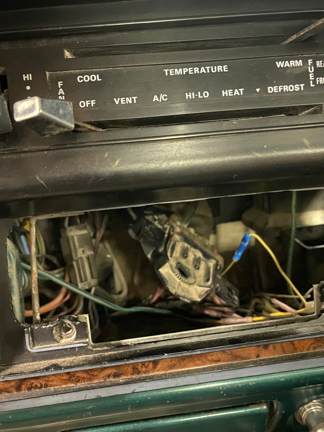

Can you take a picture of it and its' location.

I sure will when I get back home, it’s location is behind the radio

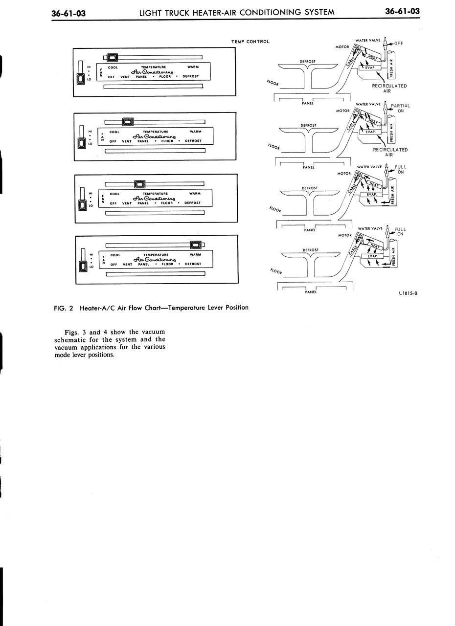

Have a look at this thread. It's going to be hard to locate anything new but if you keep searching with the part # like NOS on Ebay eventually one will emerge. Used is hit and miss but still a possibility.

Thanks for the tip, that thread is exactly what I was looking for. Now I just need to keep searching

So you need the 2 contact, 8 port one I would guess? So looks like the plastic stud with the star washer broke off? I have sold a number of used ones (that were reused just fine), to a few members on here. In the pic that is the controller turned up side down. So that broke switch is the bottom one.
FTE safe seller. https://www.ford-trucks.com/forums/forum238/
I am guessing this is not the one you need.
https://www.dennis-carpenter.com/car...AaAgbtEALw_wcB
https://www.macsautoparts.com/1978-7...8-46648-1.html
OOS. https://cgfordparts.com/vacuum-switc...-19b888-a.html
Wow $ https://www.musclecarsandclassics.ca...heater-factory
The plastic stud breaks off the lower switch when you hot rod the lever. And the rubber gasket is sticky or been in place a while. No idea how the 2 contact part got broke.

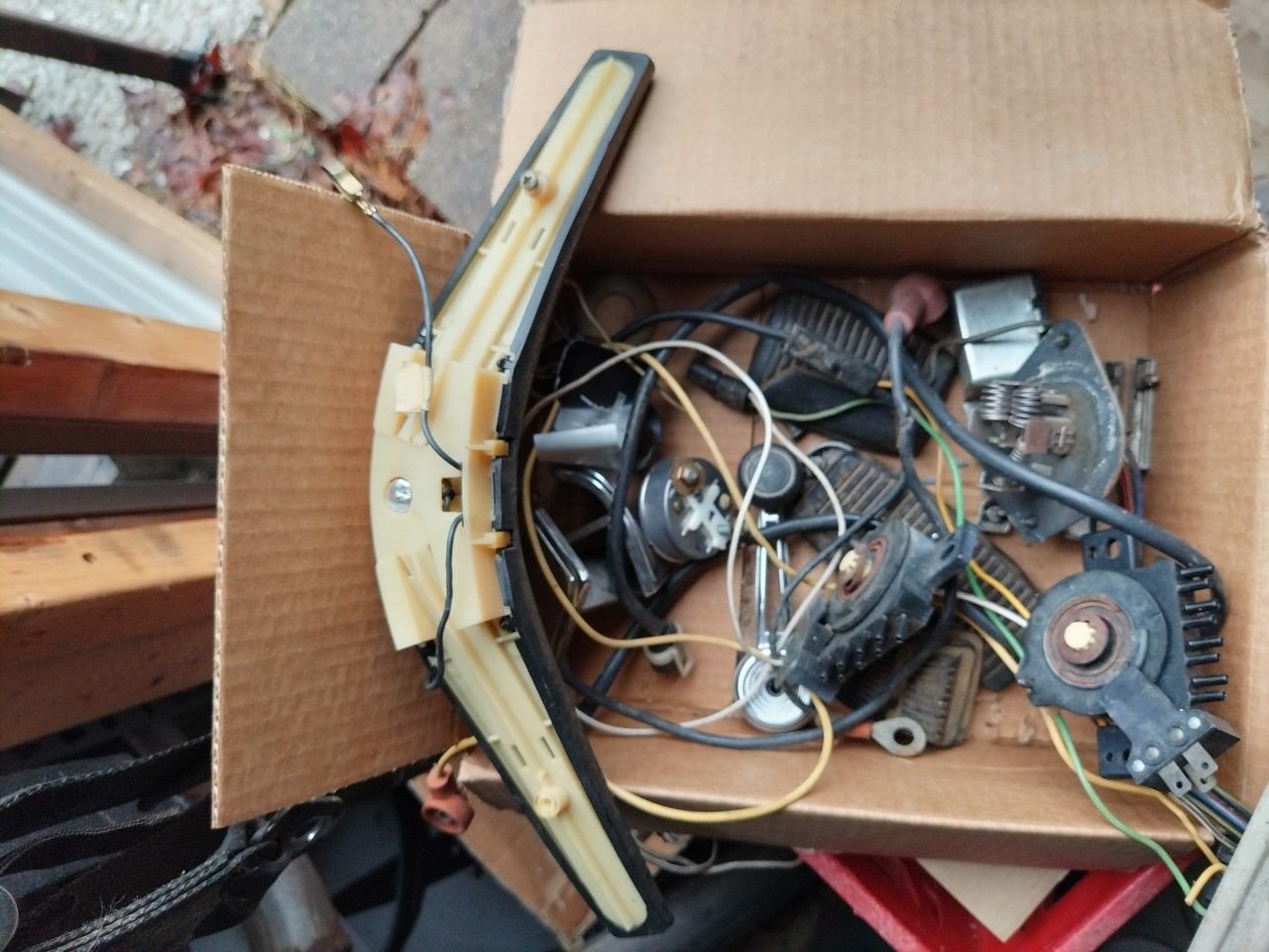

I have a couple left, in case you can not locate a new, repop or NOS one. PM me if interested.
