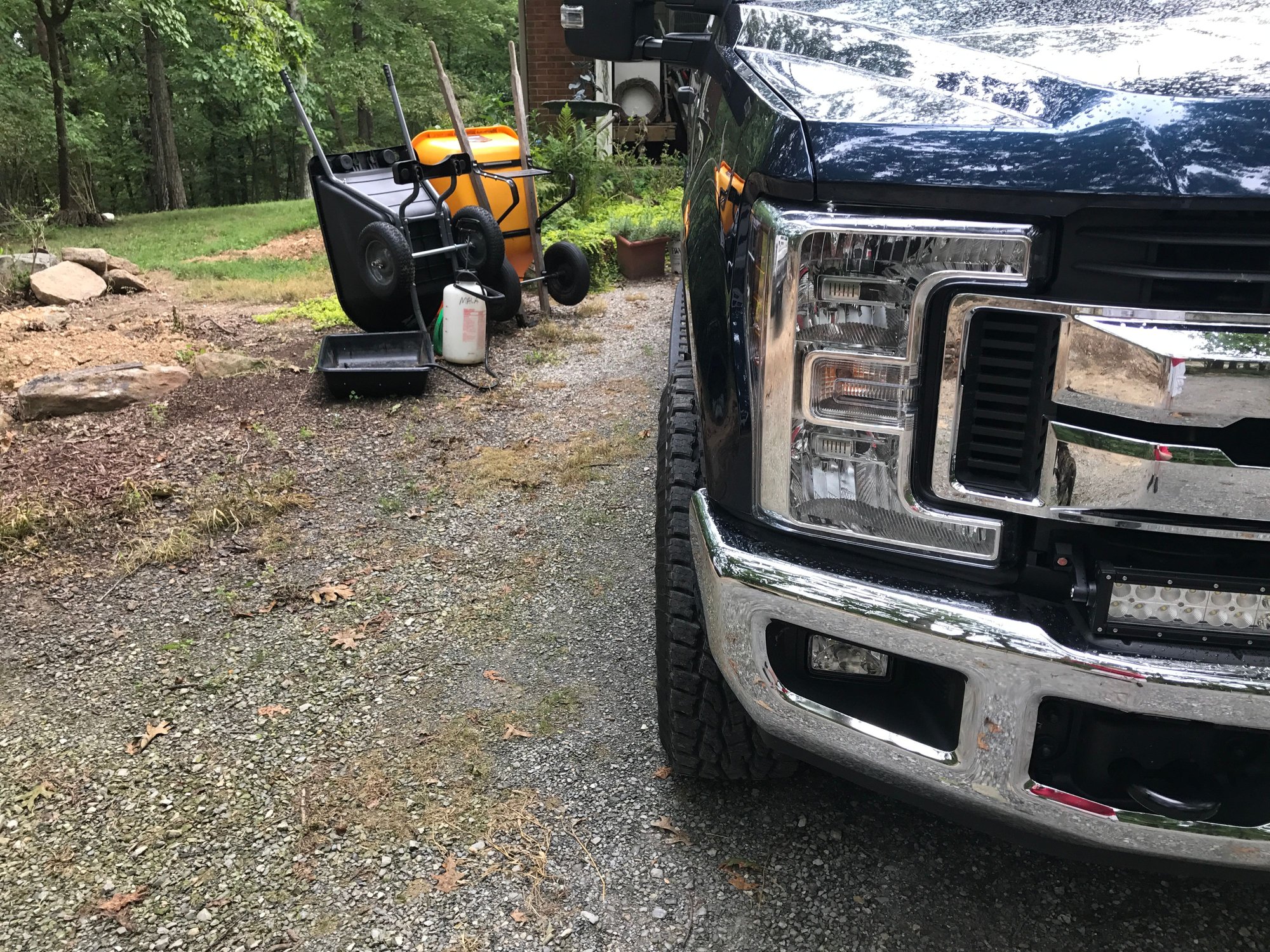

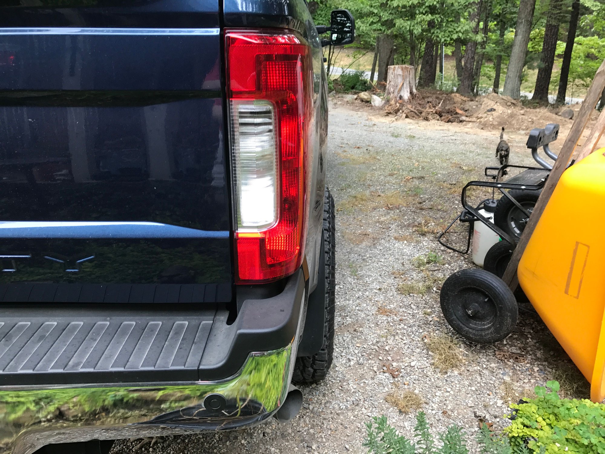

+12 and +18mm is a more popular aftermarket option, and it should keep your tires from sticking out past the fenders if that’s what you’re after. Also, Ford made a lot of wheels 2017+ that are not PVD plated and don’t suffer from peeling issues. Any one of those would be a good choice as well.
My last set were 0mm offset, 9” wide wheels, and 285 series tires:
