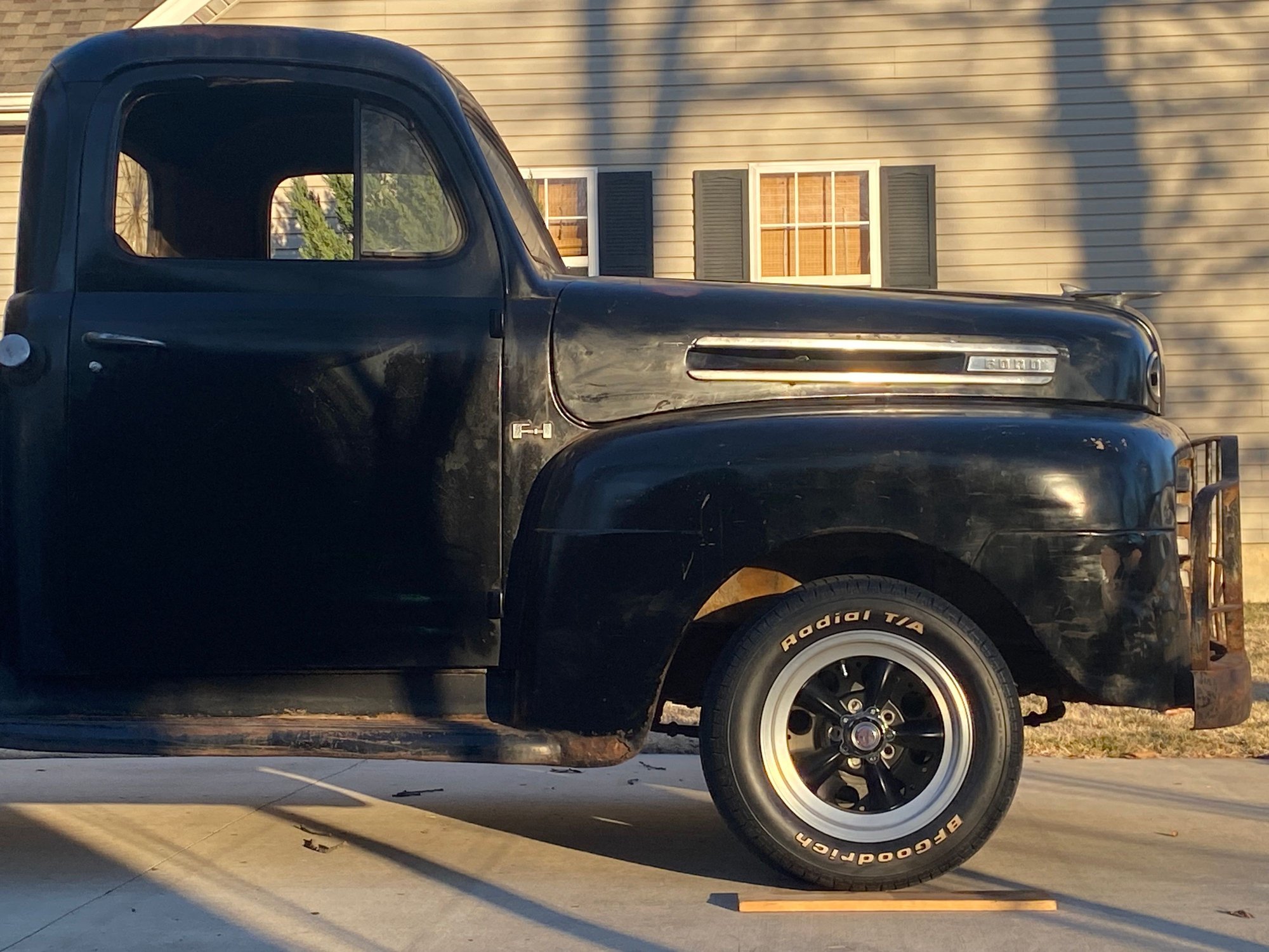

Here are the 15” Torque Thrusts from my Mustang that I shove up to see how it looks. I like a lot, but I think I’ll go with 17x8s. does anyone know how big in diameter I can go on stock suspension? I may pull a few leaves in the future also

Firing up the wayback machine, here's what H70x15 front and L60x15 rears look like. They fit under the fenders without issue on stock suspension. https://www.cokertire.com/blog/tire-...ross-reference

When changing wheels make sure you check for center hole clearance. My 51 F1 has the CPP disk brake conversion on the front, which utilizes the mid seventies F100 disk. The current AR Torque Thrust wheels center hole is slightly smaller than the protrusion on the rotor, thus it will not lie flat against the disk hub. Obviously, you have to check offset, backspace, and other clearances.
