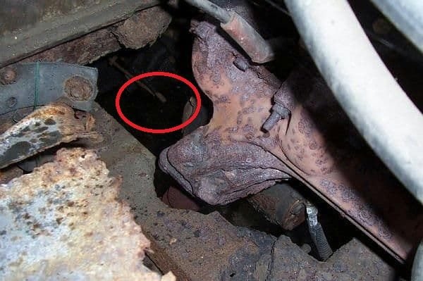

Car manifold.
Truck on top, car on bottom.

Those pictures are incredibly helpful, thank you. I'm at work now but I'll compare when I get home. I think it may have the truck style on it already.

Car manifold.
My passenger side looks identical to the truck manifold that was in it, the driver side however, looks like the picture you provided....

I believe the truck ones exit a little further back.
