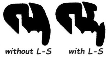

My truck came with the narrow chrome rubberized cord/strip in the seal. Would there be any issue if I replaced the seal with the plain seal, no cord/strip? Thanks!

Yes you can. but the lock strip is proper for '78 so I'm not sure why you would.

Mine had the chrome plastic mylar lock strip new, I had replaced the rubber and lock strip in '89, and most recently in 2022 we tried like three different ones (rubber seal) and where that lock strip inserts the rubber is thinnest, and after every new one tore at that last corner ... I bought a solid rubber seal and have no tears & no leaks ... and no lock strip to shrink or peal to just white in places.
I pitched the new lock strip after seeing that the chrome mylar wrinkled just unrolling it too.

Thanks but I'm not worried about "proper", just function. It's a beater truck that is not beaten but not a money pit either. I'm just fixing a small rust area and want a new seal. I have no need for the lock strip.

My classic glass guy prefers the lock strip because they're easier to install. especially with the junk we have to make do with today. Whatever you get Precision brand fits best.
