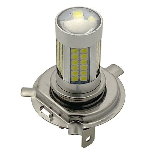

and stay FAR away from bulbs that look like these (these are the ones Jimmy hates)

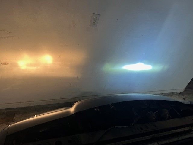

Post Edit: Here's a recent picture of a 9007 LED bulb from DieselSite like linked above, compared to a stock halogen bulb , in a factory Ford headlight housing. Beam sure looks like a pretty focused pattern that's not at all "horribly blinging and do more glair than anything" like stated above.
