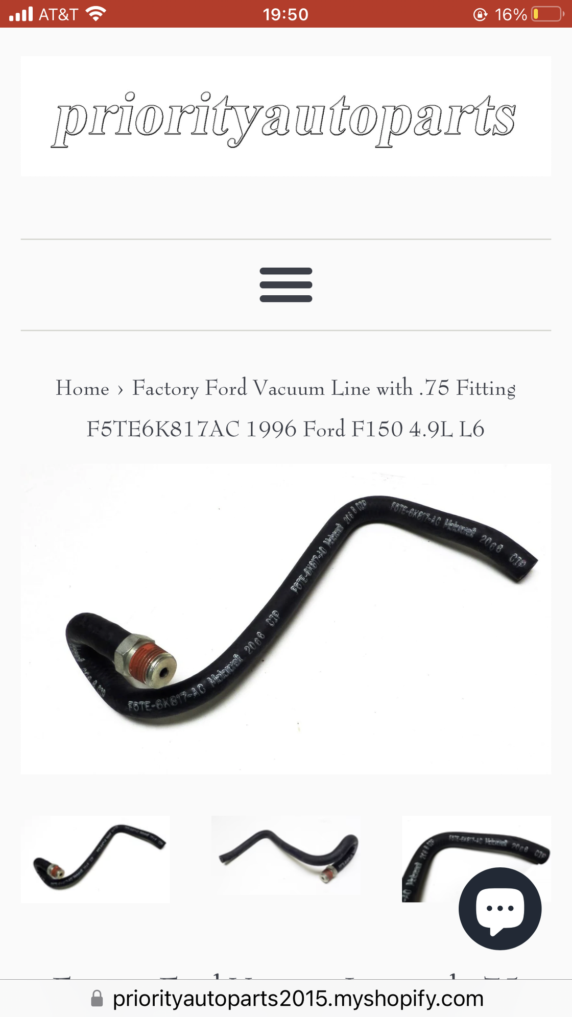

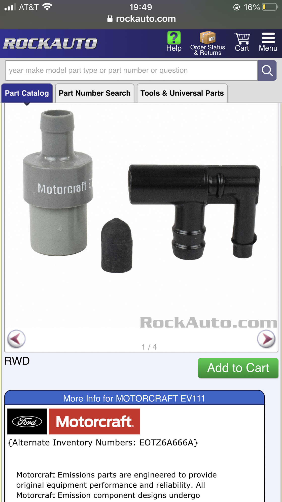

Here is my new PCV (Im still able to insert the old PCV into the grommet, and still didn’t make a difference unfortunately) and Pcv tube, as well as my model ODB2 scanner:

YOU FOUND A NEW MOLDED HOSE? Im glad i asked you to post it, i need one!~! I have a 3 part hose made from dumb off the shelf stuff lol. Had to step the size 2 times as well as create the right length.
