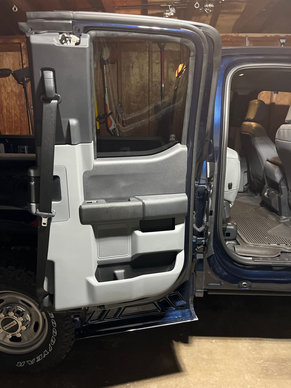

Looking to find out if anyone has been able to find out the color of speaker wires for MY2024 F250 XL SUPER CAB rear doors?

Was looking at removing rear door panels but couldn’t figure it out. Didn’t want to break anything on the new truck. Trying to tap into the wires for a Kicker hideaway sub

Thanks for the video. My truck is a super cab XL with the half doors. I see the two bottom screws. And similar plastic cover by the handle.

It’s interesting so many areas of different joints appear to lock in and out of each other
Dug around with different panel tools

This 2017 F150 rear door panel in the video sure looks the same as my 2024 f250 xl door panel in the above picture. Do you guys agree?

It looks the same as yours by looking at the pictures, they are different generation trucks though, 2017 is a 4th generation, and yours is a 5th generation, what the differences in the door panels are, I don’t know, there maybe none. Sure looks like a pain to pull off though. But I say give it a shot using the video, because right now that’s all you have.

So, There is a difference between the two trucks as far as the video and the picture above go. Fast forward and I got to the point where I replaced the speakers. Found the speaker wires colors. BUT. Traced all the wires along the floor and for the life of me could not find the same colors??? WTF. Tried the ford dealer, Crutchfield, U- tube and the Google machine. This headache is on hold until further notice.
