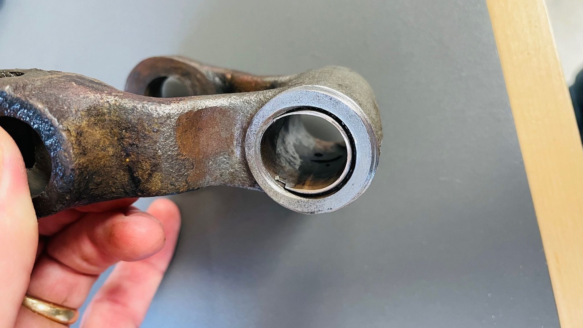

So I got the leaf springs out and discovered a few things. The spring eye bushings appear to be completely worn out. They aren't binding, but they have a lot of slop in them. I'm assuming they shouldn't be this way. Here is a link to a YouTube short clip I made showing the play.

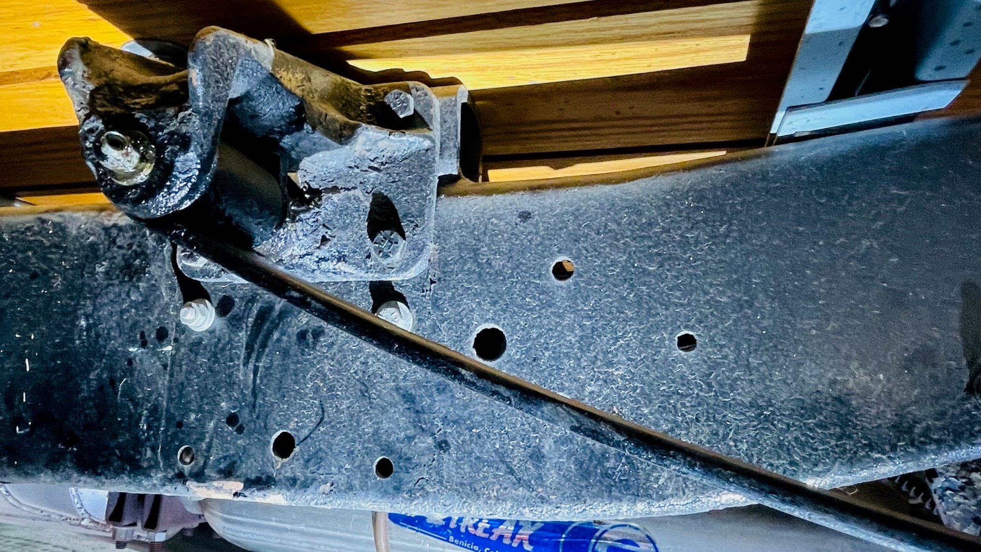

The other thing I discovered is that the front of the rear shackle has been raised up by four inches which prevents access to the hole where you would normally be able to drive the shackle pin out. Does anyone think it's a good idea to leave the bushings alone with that much play in them? Thanks.

Replace them. They're not that expensive. You'll need to check the pins. With that much slop they may need replacing as well. If you have a slide hammer you can pull the pins without having to use the hole in the frame.
'Truck looks very clean in the picture and video.

You indicated the rear was 'high'
the repositioning of the front spring mount was a former attempt to lower the rear stance.
Be sure to check the integrity of the weld, etc of what appears to be an angle iron to extend the frame rail vertically
by attaching it to the top frame rail
Mid Fifties had some instructions on their web site about ride height, methods, etc.
One I believe simply 'flipped' the front spring mount if i recall correctly
i think their web site is still active, the instructions were downloadable as pdf files

The rear isn't high per se, it's just higher than the front. It's got a decent rake to it and could stand to lose a little height in back which will happen with some of the leafs out. The front is a Camaro clip and rides low. The two top shackle bolts are going into square tubing which has been welded to the frame. Seems solid enough, but initially threw me off.

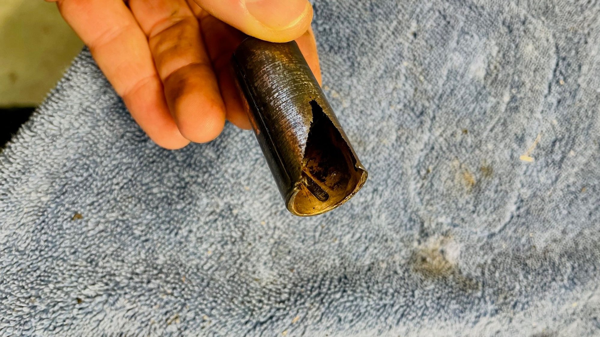

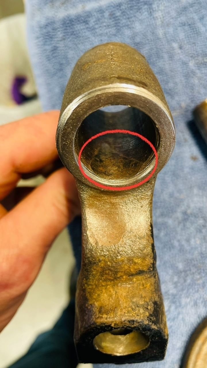

Starting to press out the bushings and discovered they are VERY worn, which is fine because I've got new ones coming, but one of the bushings is worn right through and into the steel. Does anyone think I can install the new bushing into this piece as is or should I be trying to source a replacement?

In a perfect world where you're gonna use that truck 7 days per week? Yeah I'd replace it.
In an imperfect world where the truck is a rarely used toy? Don't worry about it.
If you can find one for $5 locally, do it. But if you're paying for shipping and stuff. nahhh

That's the exact type of answer I always hope to get. Reasonable. In this case the owner wants it done right and agreed to have that piece replaced. I was shocked to find that shackle easy to find new for $48, so I'll replace it. In the meantime my lift is tied up while I wait for these parts to traverse the country

In your last post it's a good thing you are replacing the shackle. With it worn oval like that your new bushing will just eventually break again.
