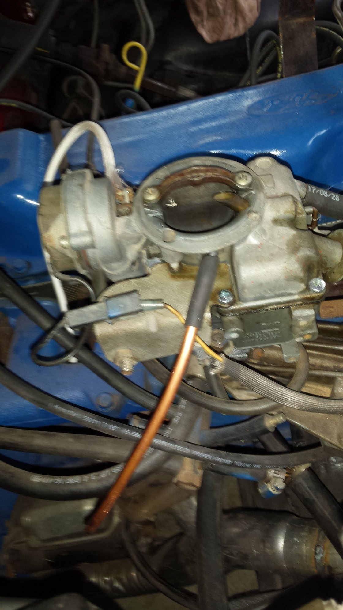

First on the factory log exh manifold there is a tube that passes thru the manifold and why you dont get a exh leak with the tubes missing.
On the top of the carb by the air filter base there is a nipple that should have a short hose going to a metal tube that runs down to the top of the log manifold.
On the bottom of the log manifold there is the other side of the tube that runs thru the manifold. There is another metal tube that run from there up to a fitting on the side of the choke housing where this screws into. This tube should have a insulating sleve on ti to keep it hot.
The metal tubes just push into the manifold holes. Dorman makes a kit to repair the metal tubes as they rust off.
Now for the EFI manifolds and the hot air asst. tubing.

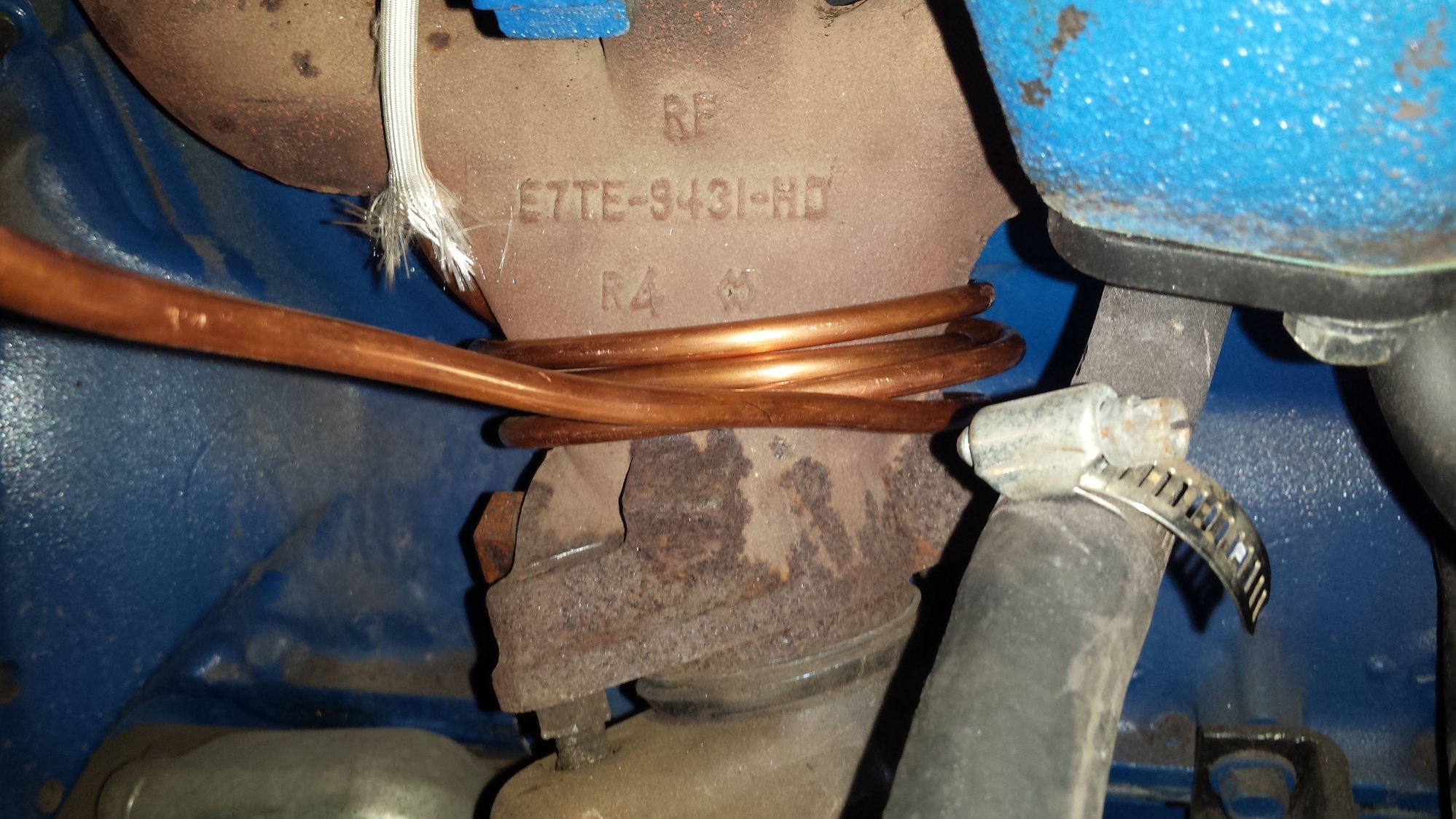

The EFI manifold do not have the tube that passes thru the manifold as it is not needed for EFI so you need to come up with a way to get heat to the carb choke.

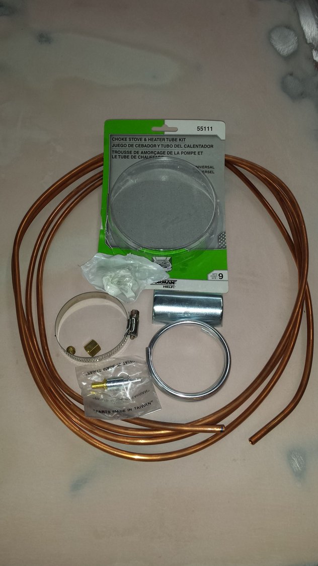

My fix was to get copper tubing and run it from the carb filter base to 1 of the manifolds wrap it around think I did 4 times but should have been more, then up to the choke housing.
When I first did this I found I was not getting enough heat to the choke so I took header wrap and wrapped the copper tubing and manifold to trap more heat and that did the trick, that is why I said more wraps with the copper tubing.
Copper tubing and the Dorman hot air repair kit
Clean cool air for the hot air choke like the factory did
A few wraps around the manifold, dont have any of the header wrap over it
Hot air to choke like the factory with the covering to keep the heat in and a fitting from the Dorman kit

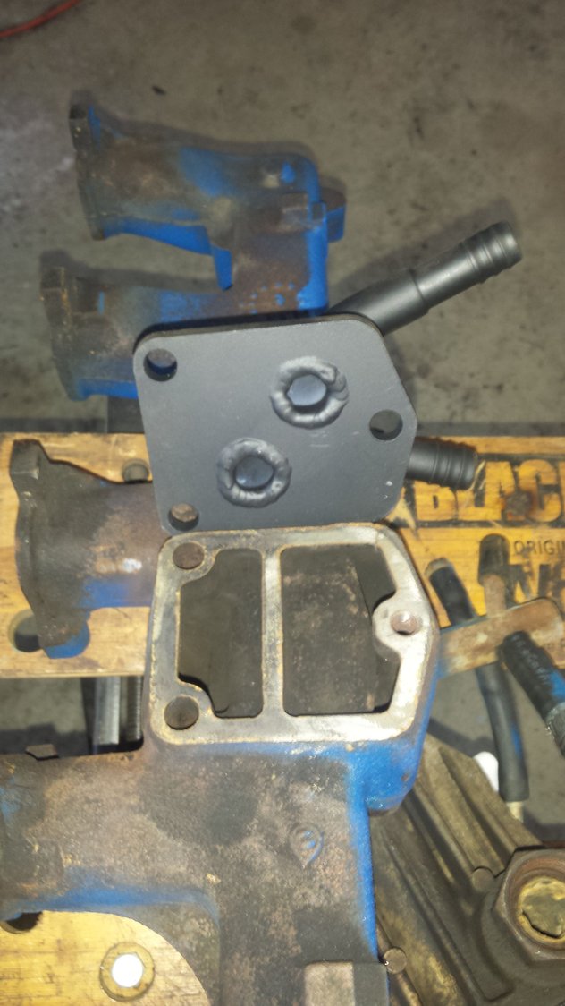

Now also know when running EFI manifolds or headers there is no heat to the bottom of the intake manifold factory or after market.
This may not be a big deal if you dont drive the truck when cold. When cold the fuel can drop out of the air / fuel mix and pool on the intake floor and cause issues with it running.
Ebay had a plate with nipples that bolted to the intake manifold and you ran hot water thru it to heat the manifold. In the picture of the tubing wrapped around the manifold you can just make out 1 of the nipples with the hose on it.
I have driven my truck when it was 20*f and that is when I found the choke did not open all the way, still on fast idle, and had to use the header wrap but other wise motor runs great.
Hope that helps and any questions just ask. I have a old post on the EFI manifold swap on here.
Dave ----

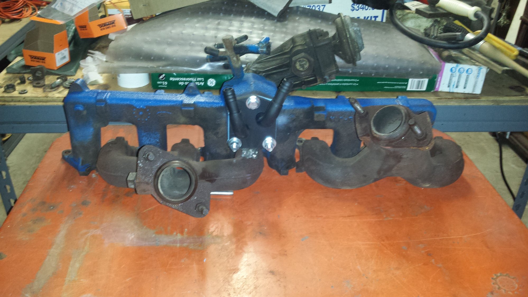

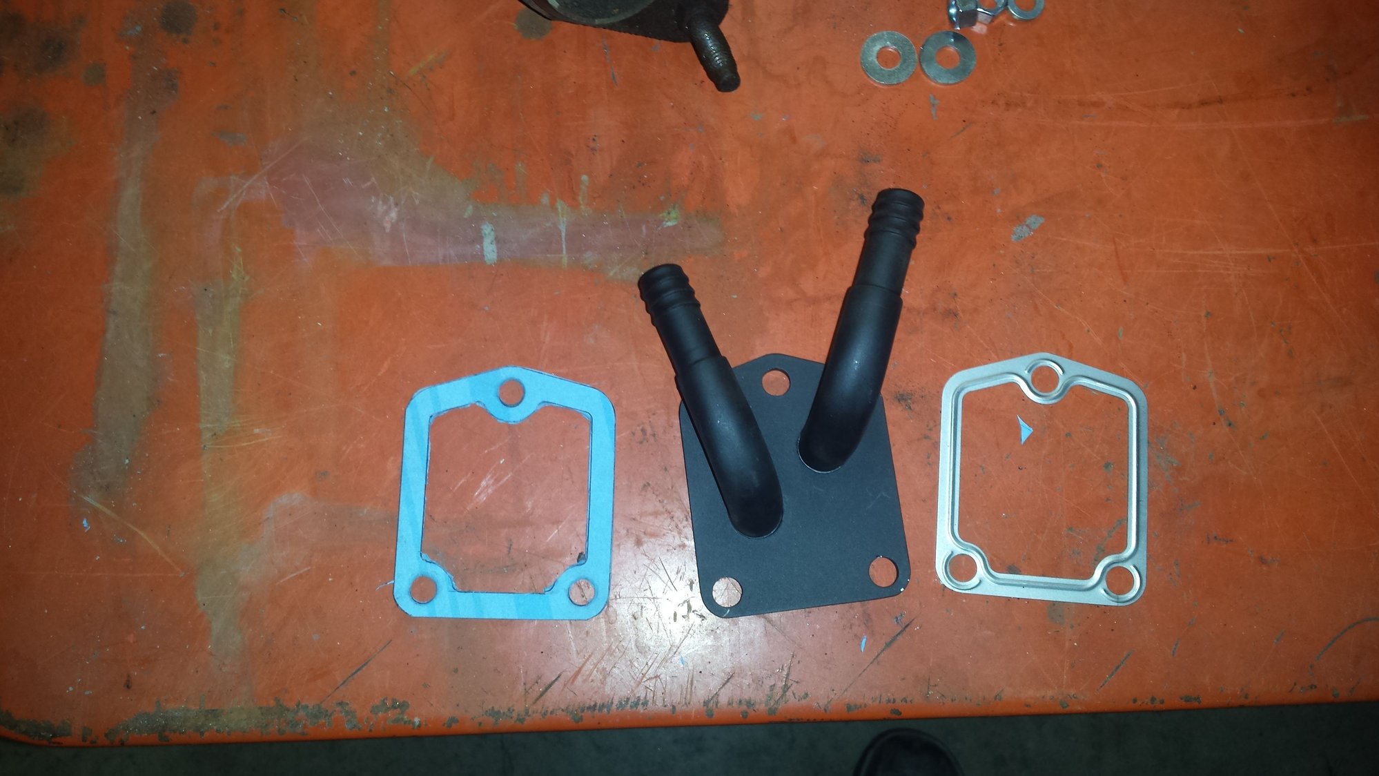

Here is the plate I bought on Ebay. I dont know if you can find them now but can be made with plate and fittings.
I used the factory gasket as a pattern to make a gasket (blue) between the plate and manifold.
Picture of the plate to the manifold.
How the manifolds sit when bolted to the motor.
Thing is you need to put the manifolds on a flat surface like this and check where the flat washers in the manifolds. IIRC they are not evenand need to make them so for propper tighting. I used a belt sander on the EXH manifolds to make them even.
Dave ----

Oh forgot the water flow
I go from the motor to the plate on the manifold then to the heater core and back to the motor.
So the plate is just put in between the motor and heater core.
If your hose is lone enough you just need 2 more hose clamps.
